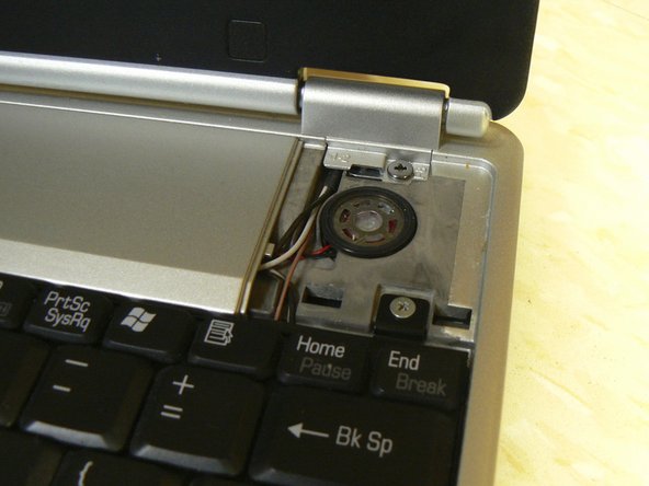

    • Use a plastic opening tool to unsnap the right hand side speaker cover.
  5. Toshiba Portege M300 LCD Replacement: crwdns2935265:05crwdnd2935265:01crwdnd2935265:02crwdne2935265:0 Toshiba Portege M300 LCD Replacement: crwdns2935265:05crwdnd2935265:02crwdnd2935265:02crwdne2935265:0
    • Remove the rest of the cover by sliding it to the right and lifting the right edge.

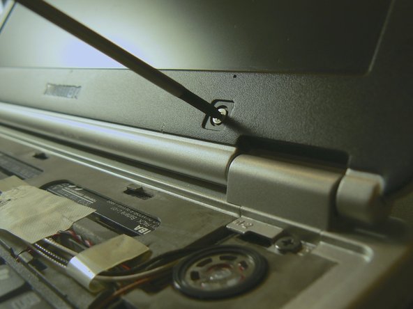

    • Remove all eight plastic circular covers on the plastic screen bezel.
    • Only seven of these plastic covers will contain screws underneath.
    • Unscrew all seven screws with a Phillips head #000 screwdriver.

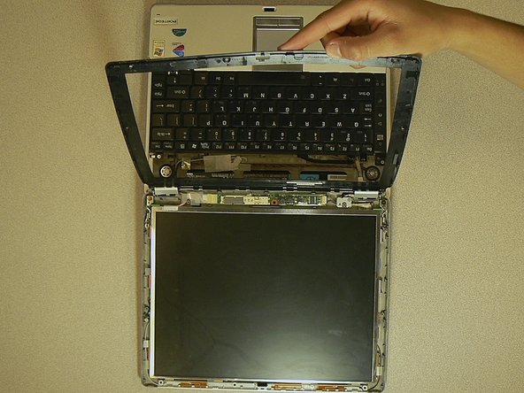

    • Use a plastic opening tool to separate the screen bezel from the rest of the case.
    • Pull at the top edge of the LCD to separate it from the top part of the case.
    • Only separate the casing and the LCD by an inch—there are still wires connecting them.
