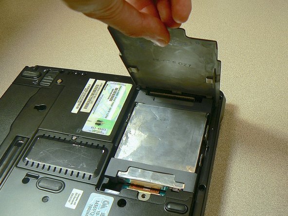

    • Turn the computer over onto the back.
    • Use a Phillips #1 screwdriver to remove the screw from the hard drive cover.
    • Lift and remove the cover.

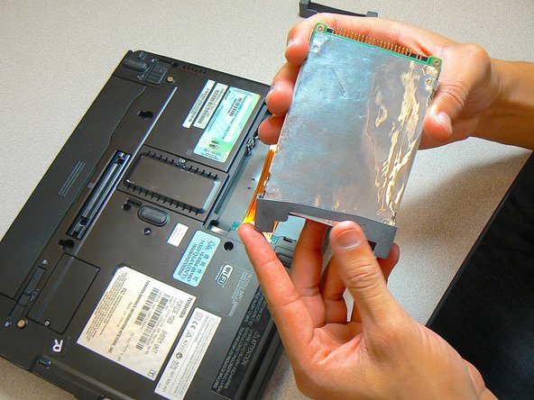

  5. Toshiba Portege M300 Hard Drive Replacement: crwdns2935265:05crwdnd2935265:01crwdnd2935265:03crwdne2935265:0 Toshiba Portege M300 Hard Drive Replacement: crwdns2935265:05crwdnd2935265:02crwdnd2935265:03crwdne2935265:0 Toshiba Portege M300 Hard Drive Replacement: crwdns2935265:05crwdnd2935265:03crwdnd2935265:03crwdne2935265:0
    • Carefully remove the hard drive from the IDE cable by pulling on the black connector.
    • Do not pull the orange cable.
