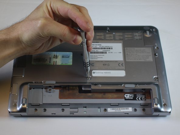

  4. Toshiba NB305 Wifi Card Replacement, Wifi Card: crwdns2935265:04crwdnd2935265:01crwdnd2935265:03crwdne2935265:0 Toshiba NB305 Wifi Card Replacement, Wifi Card: crwdns2935265:04crwdnd2935265:02crwdnd2935265:03crwdne2935265:0 Toshiba NB305 Wifi Card Replacement, Wifi Card: crwdns2935265:04crwdnd2935265:03crwdnd2935265:03crwdne2935265:0
    • Locate the two torx T-6 screws on the back of the laptop and remove them.
    • 6mm Torx T-6 Screws

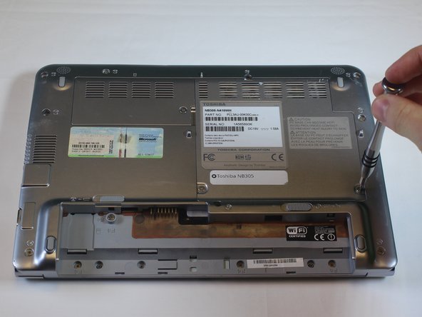

  5. Toshiba NB305 Wifi Card Replacement: crwdns2935265:05crwdnd2935265:01crwdnd2935265:02crwdne2935265:0 Toshiba NB305 Wifi Card Replacement: crwdns2935265:05crwdnd2935265:02crwdnd2935265:02crwdne2935265:0
    • Using a spudger pry the panel up.

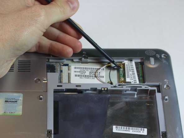

  6. Toshiba NB305 Wifi Card Replacement: crwdns2935265:06crwdnd2935265:01crwdnd2935265:02crwdne2935265:0 Toshiba NB305 Wifi Card Replacement: crwdns2935265:06crwdnd2935265:02crwdnd2935265:02crwdne2935265:0
    • Using a spudger pry up and off the two wire connections.
    • Note that the black wire is on the top of the card and the white is the bottom.

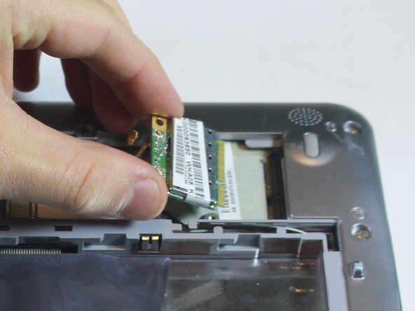

  8. Toshiba NB305 Wifi Card Replacement: crwdns2935265:08crwdnd2935265:01crwdnd2935265:02crwdne2935265:0 Toshiba NB305 Wifi Card Replacement: crwdns2935265:08crwdnd2935265:02crwdnd2935265:02crwdne2935265:0
    • Grip both sides of the wifi card with your hand.
    • Lift up on the card and pull the card out of the slot
