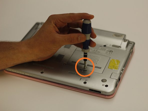

    • Use a bit driver and a Phillips #0 bit to remove the one 5 mm retaining screw.
    • Lift the panel up and out of the way.
