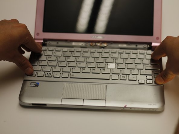

  5. Toshiba NB205 N330PK Keyboard Replacement, Keyboard: crwdns2935265:05crwdnd2935265:01crwdnd2935265:02crwdne2935265:0 Toshiba NB205 N330PK Keyboard Replacement, Keyboard: crwdns2935265:05crwdnd2935265:02crwdnd2935265:02crwdne2935265:0
    • Use the spudger to gently pry around the keyboard. This will release the keyboard assembly from the body.
  6. Toshiba NB205 N330PK Keyboard Replacement: crwdns2935265:06crwdnd2935265:01crwdnd2935265:02crwdne2935265:0 Toshiba NB205 N330PK Keyboard Replacement: crwdns2935265:06crwdnd2935265:02crwdnd2935265:02crwdne2935265:0
    • Reach under the keyboard and disconnect the electrical connection.
    • Lift the broken keyboard off.

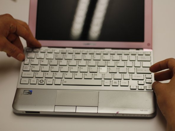

  7. Toshiba NB205 N330PK Keyboard Replacement: crwdns2935265:07crwdnd2935265:01crwdnd2935265:03crwdne2935265:0 Toshiba NB205 N330PK Keyboard Replacement: crwdns2935265:07crwdnd2935265:02crwdnd2935265:03crwdne2935265:0 Toshiba NB205 N330PK Keyboard Replacement: crwdns2935265:07crwdnd2935265:03crwdnd2935265:03crwdne2935265:0
    • Reattach the new electrical connection into the old connection location.
    • Place the keyboard into the original location starting with the bottom first.
    • Gently press the keyboard down to secure it into its original location.
