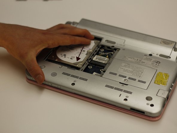

    • To expose the hard drive, use a bit driver and a Star #0 bit to remove the two designated screws.
    • Gently lift the panel off.
  2. Toshiba NB205 N330PK Hard Drive Replacement: crwdns2935265:02crwdnd2935265:01crwdnd2935265:02crwdne2935265:0 Toshiba NB205 N330PK Hard Drive Replacement: crwdns2935265:02crwdnd2935265:02crwdnd2935265:02crwdne2935265:0
    • With the panel removed, slide the hard drive towards the top of the netbook with moderate force.
    • This will free the hard drive from its original location.
  3. Toshiba NB205 N330PK Hard Drive Replacement: crwdns2935265:03crwdnd2935265:01crwdnd2935265:02crwdne2935265:0 Toshiba NB205 N330PK Hard Drive Replacement: crwdns2935265:03crwdnd2935265:02crwdnd2935265:02crwdne2935265:0
    • Obtain a new hard drive.
    • Apply firm pressure to secure the new hard drive into the old hard drive's location.
  4. Toshiba NB205 N330PK Hard Drive Replacement: crwdns2935265:04crwdnd2935265:01crwdnd2935265:02crwdne2935265:0 Toshiba NB205 N330PK Hard Drive Replacement: crwdns2935265:04crwdnd2935265:02crwdnd2935265:02crwdne2935265:0
    • Place the back panel in its original position.
    • Using the bit driver and Phillips #0 bit, secure the hard drive panel to the netbook body.
