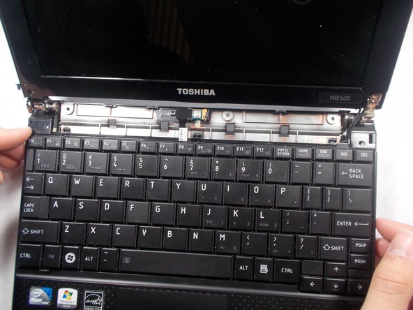

  8. Toshiba Mini NB505 Keyboard Replacement: crwdns2935265:08crwdnd2935265:01crwdnd2935265:01crwdne2935265:0
    • Lift the keyboard gently away from the computer.
    • Do not attempt to fully remove the keyboard, as it is attached to the laptop by a ribbon cable.
  9. Toshiba Mini NB505 Keyboard Replacement: crwdns2935265:09crwdnd2935265:01crwdnd2935265:03crwdne2935265:0 Toshiba Mini NB505 Keyboard Replacement: crwdns2935265:09crwdnd2935265:02crwdnd2935265:03crwdne2935265:0 Toshiba Mini NB505 Keyboard Replacement: crwdns2935265:09crwdnd2935265:03crwdnd2935265:03crwdne2935265:0
    • Locate the ribbon wire under the keyboard. Slide the white tabs forward and the keyboard will come loose.
