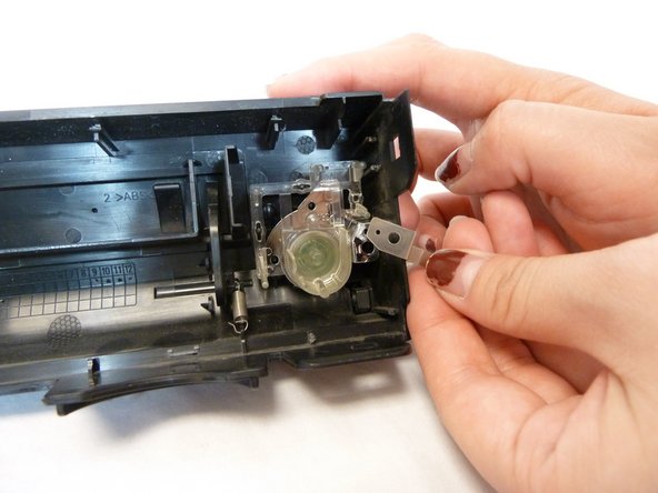

      • Using your hands, pop off the black console from each hinge surrounding the case.
      • There are a total of 7 hinges.
    2. Toshiba HD-A2 Power Button Replacement: crwdns2935265:02crwdnd2935265:01crwdnd2935265:01crwdne2935265:0
      • With the inside of the console facing up, the power button will be encased in clear plastic located on the right side of the console.
    3. Toshiba HD-A2 Power Button Replacement: crwdns2935265:03crwdnd2935265:01crwdnd2935265:02crwdne2935265:0 Toshiba HD-A2 Power Button Replacement: crwdns2935265:03crwdnd2935265:02crwdnd2935265:02crwdne2935265:0
      • Use a Phillips #1 screwdriver to remove the single screw holding the power button to the console.
      • After taking out the screw, the small piece of metal underneath will come loose. Carefully place this part aside.
    4. Toshiba HD-A2 Power Button Replacement: crwdns2935265:04crwdnd2935265:01crwdnd2935265:01crwdne2935265:0
      • Using your fingers, gently pull out the power button. You can push it from the outside to help loosen it from its hinges.
