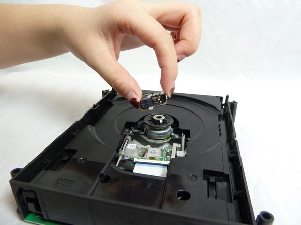

  13. Toshiba HD-A2 Optical Lens Replacement, Optical Lens: crwdns2935265:013crwdnd2935265:01crwdnd2935265:01crwdne2935265:0
    • The optical lens will be resting aside the small green circuit board.
  14. Toshiba HD-A2 Optical Lens Replacement: crwdns2935265:014crwdnd2935265:01crwdnd2935265:02crwdne2935265:0 Toshiba HD-A2 Optical Lens Replacement: crwdns2935265:014crwdnd2935265:02crwdnd2935265:02crwdne2935265:0
    • Using a prying tool, wedge the edge of the tool underneath the end of the optical lens closest to the green circuit board. Gently push down to pop off the optical lens.
