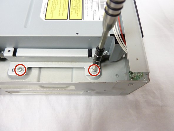

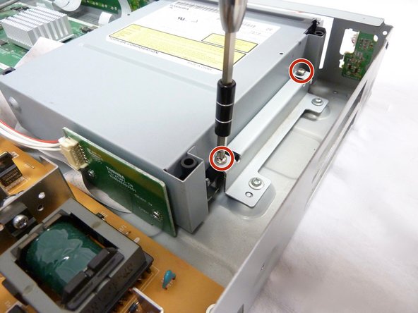

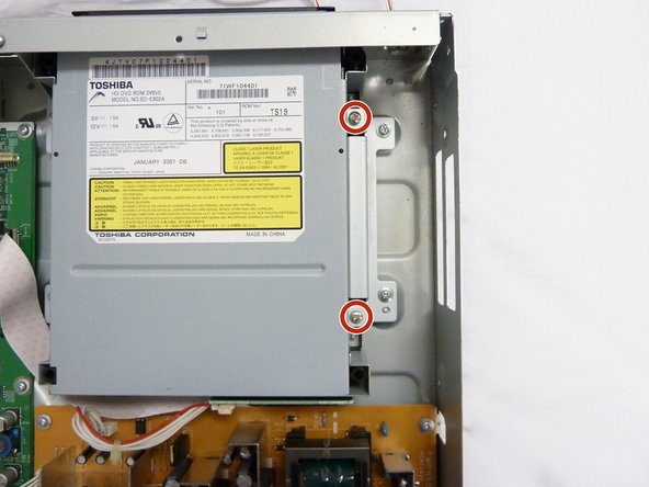

  4. Toshiba HD-A2 Optical Drive Replacement, Optical Drive: crwdns2935265:04crwdnd2935265:01crwdnd2935265:03crwdne2935265:0 Toshiba HD-A2 Optical Drive Replacement, Optical Drive: crwdns2935265:04crwdnd2935265:02crwdnd2935265:03crwdne2935265:0 Toshiba HD-A2 Optical Drive Replacement, Optical Drive: crwdns2935265:04crwdnd2935265:03crwdnd2935265:03crwdne2935265:0
    • Remove five 6mm Phillips screws with a Phillips #2 screwdriver.
    • The 2 screws on the right of the cartridge are better shown in the second and third photos.

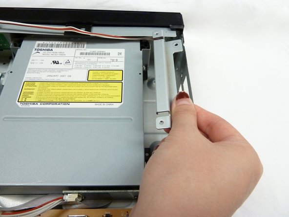

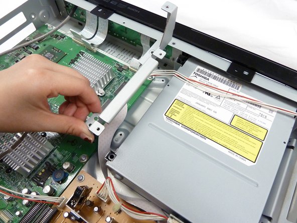

  6. Toshiba HD-A2 Optical Drive Replacement: crwdns2935265:06crwdnd2935265:01crwdnd2935265:03crwdne2935265:0 Toshiba HD-A2 Optical Drive Replacement: crwdns2935265:06crwdnd2935265:02crwdnd2935265:03crwdne2935265:0 Toshiba HD-A2 Optical Drive Replacement: crwdns2935265:06crwdnd2935265:03crwdnd2935265:03crwdne2935265:0
    • Using your fingers, gently remove the metal pieces on each side of the cartridge and carefully place them aside.

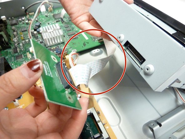

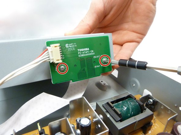

  7. Toshiba HD-A2 Optical Drive Replacement: crwdns2935265:07crwdnd2935265:01crwdnd2935265:02crwdne2935265:0 Toshiba HD-A2 Optical Drive Replacement: crwdns2935265:07crwdnd2935265:02crwdnd2935265:02crwdne2935265:0
    • Gently lift the cartridge. Remove two 4mm Phillips screws from the green circuit board.
  8. Toshiba HD-A2 Optical Drive Replacement: crwdns2935265:08crwdnd2935265:01crwdnd2935265:01crwdne2935265:0
    • Using your fingers, gently pull off the wires.
  9. Toshiba HD-A2 Optical Drive Replacement: crwdns2935265:09crwdnd2935265:01crwdnd2935265:02crwdne2935265:0 Toshiba HD-A2 Optical Drive Replacement: crwdns2935265:09crwdnd2935265:02crwdnd2935265:02crwdne2935265:0
    • Using your fingers, pull off the green circuit board from the cartridge and carefully place it down.
    • Be careful not to rip the tape attaching the green circuit boards together.

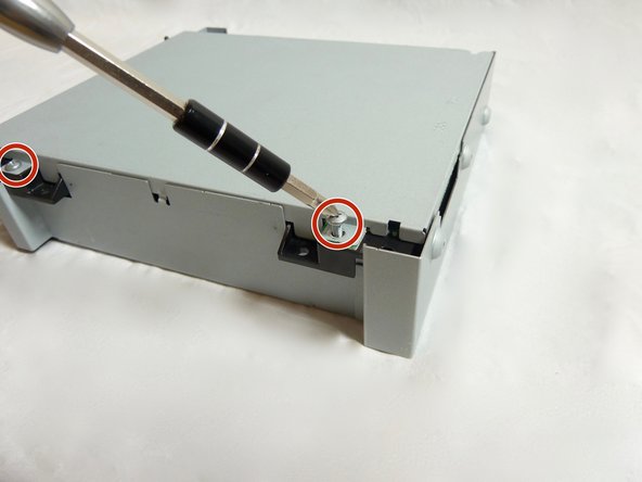

  10. Toshiba HD-A2 Optical Drive Replacement: crwdns2935265:010crwdnd2935265:01crwdnd2935265:02crwdne2935265:0 Toshiba HD-A2 Optical Drive Replacement: crwdns2935265:010crwdnd2935265:02crwdnd2935265:02crwdne2935265:0
    • Flip the cartridge over to the bare side with no stickers. Remove four 10mm Phillips screws from each corner.

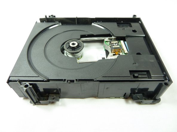

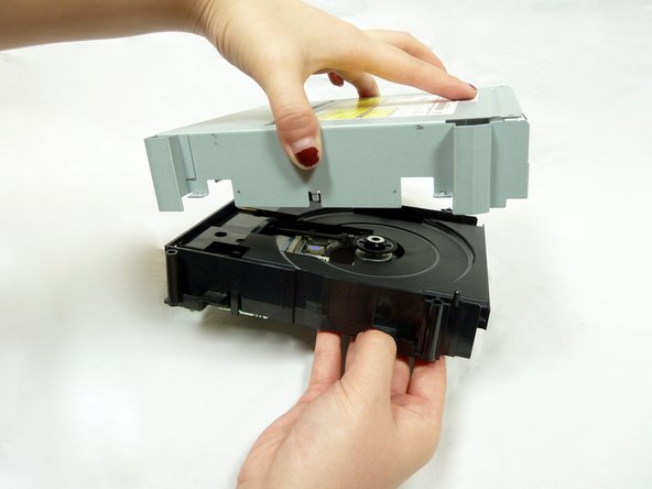

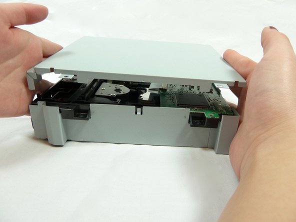

  12. Toshiba HD-A2 Optical Drive Replacement: crwdns2935265:012crwdnd2935265:01crwdnd2935265:03crwdne2935265:0 Toshiba HD-A2 Optical Drive Replacement: crwdns2935265:012crwdnd2935265:02crwdnd2935265:03crwdne2935265:0 Toshiba HD-A2 Optical Drive Replacement: crwdns2935265:012crwdnd2935265:03crwdnd2935265:03crwdne2935265:0
    • Flip over the cartridge. Using your hands, gently lift the rest of the silver case.
