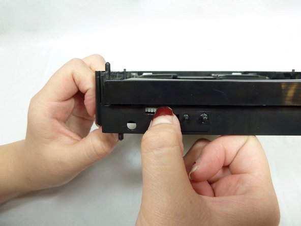

  13. Toshiba HD-A2 Drive Belt Replacement, Drive Belt: crwdns2935265:013crwdnd2935265:01crwdnd2935265:03crwdne2935265:0 Toshiba HD-A2 Drive Belt Replacement, Drive Belt: crwdns2935265:013crwdnd2935265:02crwdnd2935265:03crwdne2935265:0 Toshiba HD-A2 Drive Belt Replacement, Drive Belt: crwdns2935265:013crwdnd2935265:03crwdnd2935265:03crwdne2935265:0
    • Slide out the disc tray. If it's stuck, turn the white gear to the right to release the tray.

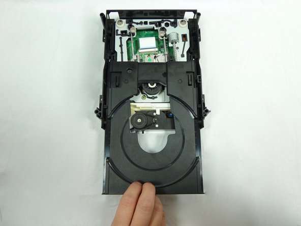

  14. Toshiba HD-A2 Drive Belt Replacement: crwdns2935265:014crwdnd2935265:01crwdnd2935265:01crwdne2935265:0
    • The drive belt is the black rubber band.

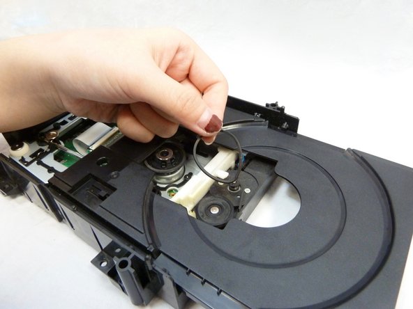

  15. Toshiba HD-A2 Drive Belt Replacement: crwdns2935265:015crwdnd2935265:01crwdnd2935265:02crwdne2935265:0 Toshiba HD-A2 Drive Belt Replacement: crwdns2935265:015crwdnd2935265:02crwdnd2935265:02crwdne2935265:0
    • Using your fingers, gently remove the drive belt.
    • If you have difficulty using your fingers, use a prying tool.
