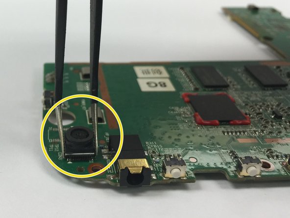

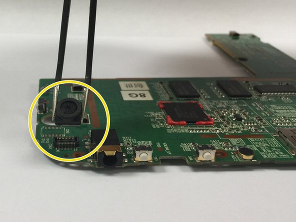

  3. Toshiba Excite 7c Camera  Replacement, Camera: crwdns2935265:03crwdnd2935265:01crwdnd2935265:03crwdne2935265:0 Toshiba Excite 7c Camera  Replacement, Camera: crwdns2935265:03crwdnd2935265:02crwdnd2935265:03crwdne2935265:0 Toshiba Excite 7c Camera  Replacement, Camera: crwdns2935265:03crwdnd2935265:03crwdnd2935265:03crwdne2935265:0
    • Locate the camera on the top portion of the motherboard as seen here.
    • Grip using the tweezers and pull directly up applying as much force as necessary to remove the camera.
