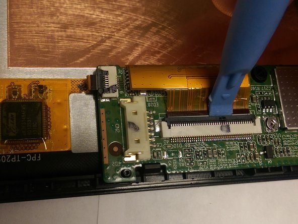

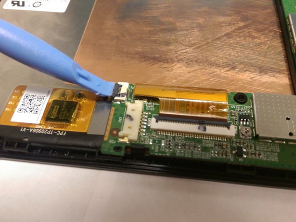

  7. Toshiba Excite 7 Rear Facing Camera Replacement, Unplugging Data Cable: crwdns2935265:07crwdnd2935265:01crwdnd2935265:03crwdne2935265:0 Toshiba Excite 7 Rear Facing Camera Replacement, Unplugging Data Cable: crwdns2935265:07crwdnd2935265:02crwdnd2935265:03crwdne2935265:0 Toshiba Excite 7 Rear Facing Camera Replacement, Unplugging Data Cable: crwdns2935265:07crwdnd2935265:03crwdnd2935265:03crwdne2935265:0
    • The screen is connected to the circuit board by 2 “Data Cables” (orange ribbons). Data cables include 3 working components, data cables, the white harness plug, and the black lever.
    • Gently flip the black lock up with an opening tool and unplug data cables.

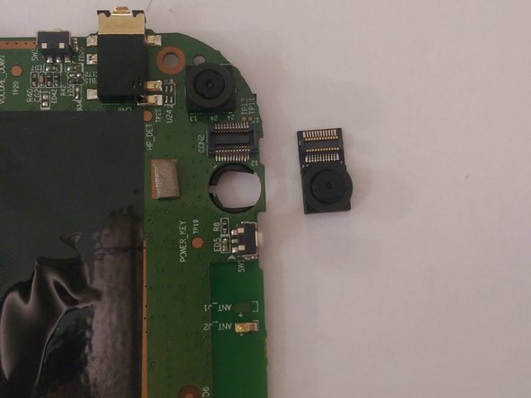

  9. Toshiba Excite 7 Rear Facing Camera Replacement, Removing rear facing camera: crwdns2935265:09crwdnd2935265:01crwdnd2935265:02crwdne2935265:0 Toshiba Excite 7 Rear Facing Camera Replacement, Removing rear facing camera: crwdns2935265:09crwdnd2935265:02crwdnd2935265:02crwdne2935265:0
    • Flip the circuit board over, the rear facing camera is the black rectangle in the upper right corner of the circuit board.
    • Gently unplug the camera from the circuit board and plug the new camera in.
