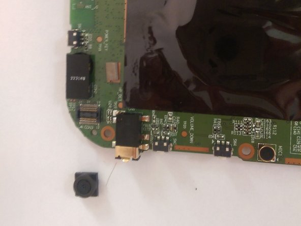

  9. Toshiba Excite 7 Front Facing Camera Replacement, Removing Front Facing Camera: crwdns2935265:09crwdnd2935265:01crwdnd2935265:02crwdne2935265:0 Toshiba Excite 7 Front Facing Camera Replacement, Removing Front Facing Camera: crwdns2935265:09crwdnd2935265:02crwdnd2935265:02crwdne2935265:0
    • Flip the circuit board over, the camera is the small black square with the circle in the middle.
    • Gently unplug the camera from the circuit board and plug the new camera back into the socket. Repeat steps in reverse order to reasemble device.
