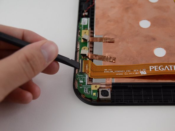

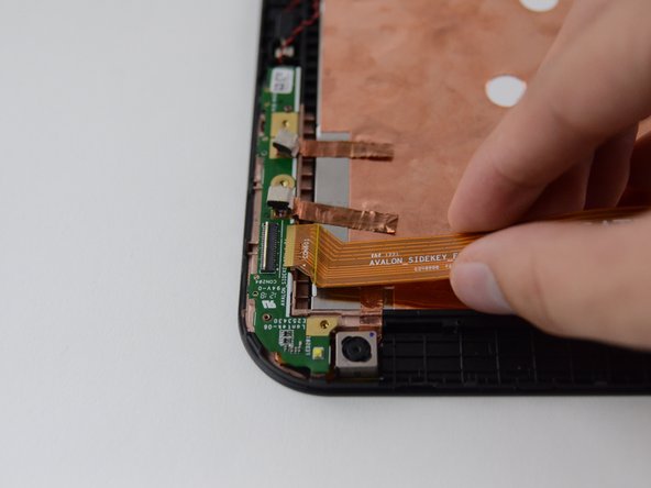

  7. Toshiba Excite 10 AT300 Rear-Facing Camera Replacement, Remove Ribbon Cable: crwdns2935265:07crwdnd2935265:01crwdnd2935265:03crwdne2935265:0 Toshiba Excite 10 AT300 Rear-Facing Camera Replacement, Remove Ribbon Cable: crwdns2935265:07crwdnd2935265:02crwdnd2935265:03crwdne2935265:0 Toshiba Excite 10 AT300 Rear-Facing Camera Replacement, Remove Ribbon Cable: crwdns2935265:07crwdnd2935265:03crwdnd2935265:03crwdne2935265:0
    • Unlock the ribbon cable housing using tweezers and/or a spudger.
    • Gently pull the ribbon cable out of its housing using the tweezers or your hands.

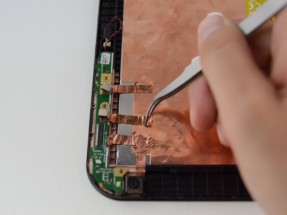

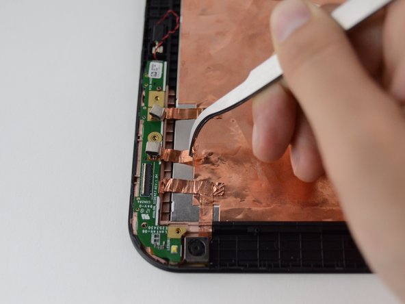

  8. Toshiba Excite 10 AT300 Rear-Facing Camera Replacement, Remove copper foil wires: crwdns2935265:08crwdnd2935265:01crwdnd2935265:03crwdne2935265:0 Toshiba Excite 10 AT300 Rear-Facing Camera Replacement, Remove copper foil wires: crwdns2935265:08crwdnd2935265:02crwdnd2935265:03crwdne2935265:0 Toshiba Excite 10 AT300 Rear-Facing Camera Replacement, Remove copper foil wires: crwdns2935265:08crwdnd2935265:03crwdnd2935265:03crwdne2935265:0
    • Pull copper tape away from the back, keeping it connected to the green rear camera board.
    • Be careful not to rip the copper tape.

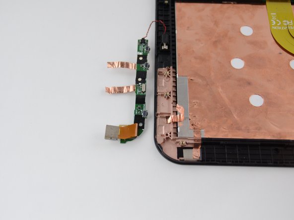

  9. Toshiba Excite 10 AT300 Rear-Facing Camera Replacement, Remove the daughter board: crwdns2935265:09crwdnd2935265:01crwdnd2935265:02crwdne2935265:0 Toshiba Excite 10 AT300 Rear-Facing Camera Replacement, Remove the daughter board: crwdns2935265:09crwdnd2935265:02crwdnd2935265:02crwdne2935265:0
    • Using your hands remove daughter board by lifting it off of the tablet chassis. Flip it over and place it next to the tablet face-down.
    • Do not disconnect the red and black wires connecting it to the vibrating mechanism.

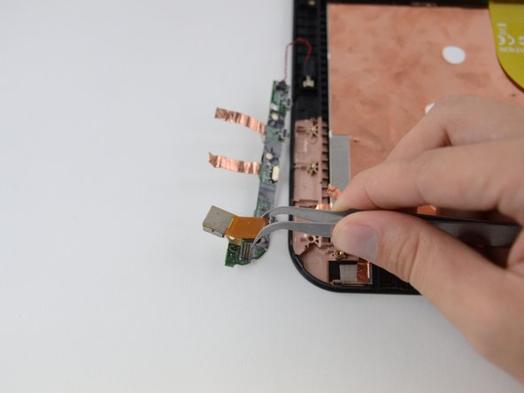

  10. Toshiba Excite 10 AT300 Rear-Facing Camera Replacement: crwdns2935265:010crwdnd2935265:01crwdnd2935265:02crwdne2935265:0 Toshiba Excite 10 AT300 Rear-Facing Camera Replacement: crwdns2935265:010crwdnd2935265:02crwdnd2935265:02crwdne2935265:0
    • Gently pinch the ribbon cable connector between two fingers or with tweezers and pull it straight outwards. The ribbon cable connector should disconnect and the camera can now be replaced.
