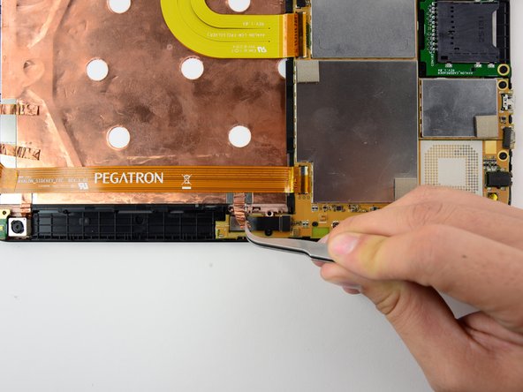

  6. Toshiba Excite 10 AT300 Front-Facing Camera Replacement, Remove the foil wire: crwdns2935265:06crwdnd2935265:01crwdnd2935265:02crwdne2935265:0 Toshiba Excite 10 AT300 Front-Facing Camera Replacement, Remove the foil wire: crwdns2935265:06crwdnd2935265:02crwdnd2935265:02crwdne2935265:0
    • Using tweezers, pull the copper foil up from the back of the camera. It should peel up easily.
    • Warning: Be careful to avoid ripping the foil.
