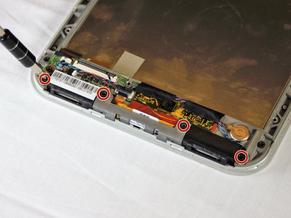

  10. Toshiba Encore WT8-A  Screen Replacement, LCD Screen: crwdns2935265:010crwdnd2935265:01crwdnd2935265:02crwdne2935265:0 Toshiba Encore WT8-A  Screen Replacement, LCD Screen: crwdns2935265:010crwdnd2935265:02crwdnd2935265:02crwdne2935265:0
    • Use the screwdriver to remove the 4-3.5mm screws on the two lower speakers.

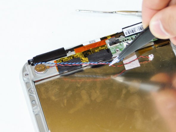

  14. Toshiba Encore WT8-A  Screen Replacement: crwdns2935265:014crwdnd2935265:01crwdnd2935265:02crwdne2935265:0 Toshiba Encore WT8-A  Screen Replacement: crwdns2935265:014crwdnd2935265:02crwdnd2935265:02crwdne2935265:0
    • Use the fine pointed tweezers to pull the 2 pieces of fabric tape from the lower board.
    • Move the speaker wires out of the way.

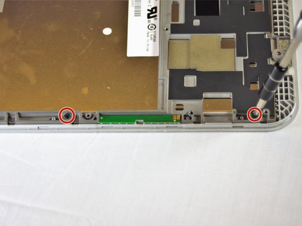

  16. Toshiba Encore WT8-A  Screen Replacement: crwdns2935265:016crwdnd2935265:01crwdnd2935265:03crwdne2935265:0 Toshiba Encore WT8-A  Screen Replacement: crwdns2935265:016crwdnd2935265:02crwdnd2935265:03crwdne2935265:0 Toshiba Encore WT8-A  Screen Replacement: crwdns2935265:016crwdnd2935265:03crwdnd2935265:03crwdne2935265:0
    • There are now 7-3.5mm Phillips head screws holding the frame to the front glass of the tablet.
    • Use the Phillips head screwdriver to remove the 7 screws.
    • The 7th screw is under the touch control board in the bottom middle that we just pried up.

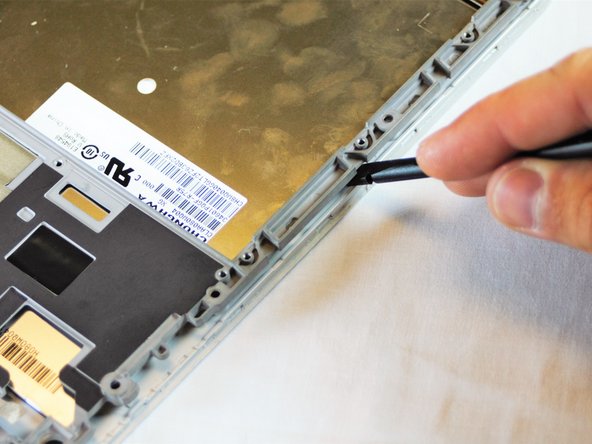

  17. Toshiba Encore WT8-A  Screen Replacement: crwdns2935265:017crwdnd2935265:01crwdnd2935265:03crwdne2935265:0 Toshiba Encore WT8-A  Screen Replacement: crwdns2935265:017crwdnd2935265:02crwdnd2935265:03crwdne2935265:0 Toshiba Encore WT8-A  Screen Replacement: crwdns2935265:017crwdnd2935265:03crwdnd2935265:03crwdne2935265:0

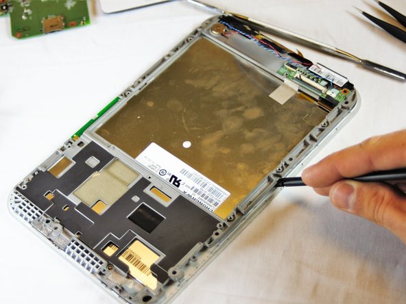

    • Use the spudger to pry your way around the frame and separate it from the front glass.
    • Be gentle when prying. There are fragile plastic clips and parts that could easily snap with too much pressure.

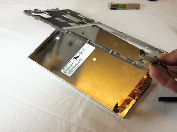

  18. Toshiba Encore WT8-A  Screen Replacement: crwdns2935265:018crwdnd2935265:01crwdnd2935265:02crwdne2935265:0 Toshiba Encore WT8-A  Screen Replacement: crwdns2935265:018crwdnd2935265:02crwdnd2935265:02crwdne2935265:0
    • When the frame is separated and loose, Lift from the top and pull the frame off the front glass, setting the glass aside.

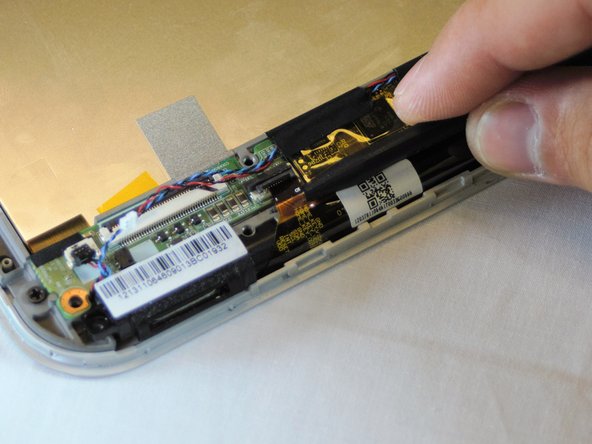

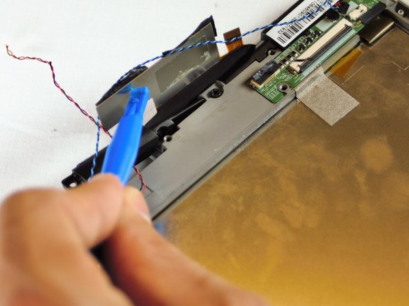

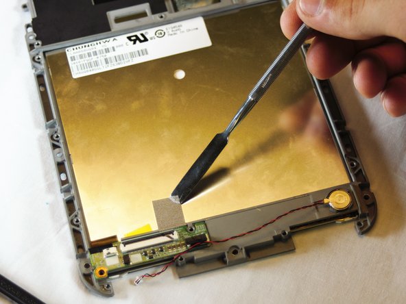

    • The screen is held to the frame with metal fabric tape at the top and bottom of the frame.
    • Use the metal spudger to peel the tape off the back of the screen.

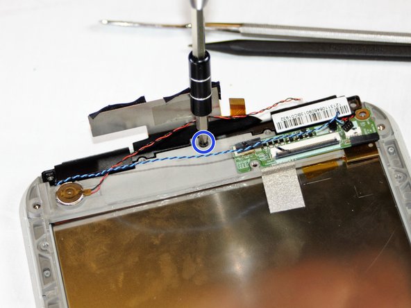

  21. Toshiba Encore WT8-A  Screen Replacement: crwdns2935265:021crwdnd2935265:01crwdnd2935265:02crwdne2935265:0 Toshiba Encore WT8-A  Screen Replacement: crwdns2935265:021crwdnd2935265:02crwdnd2935265:02crwdne2935265:0

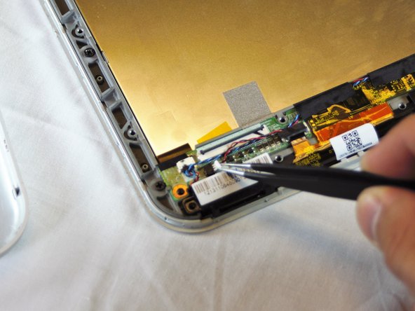

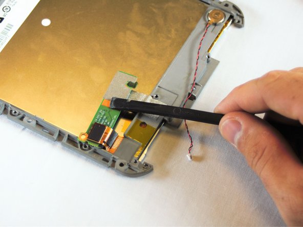

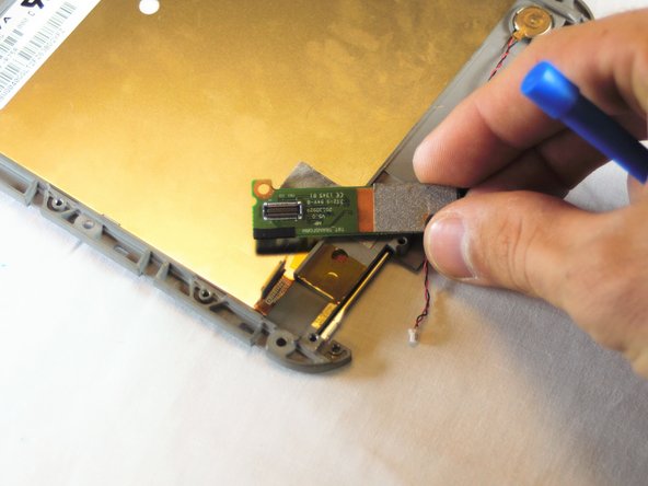

    • The last board we have to worry about is the board that holds the ribbon cable connector (from the battery removal step) and the screen connector.
    • Use the spudger to gently pry up on the bottom side of the board, as you did when removing the touch screen control board.
    • You have to make sure to loosen up the glue underneath and the board should come free from the frame.
  22. Toshiba Encore WT8-A  Screen Replacement: crwdns2935265:022crwdnd2935265:01crwdnd2935265:02crwdne2935265:0 Toshiba Encore WT8-A  Screen Replacement: crwdns2935265:022crwdnd2935265:02crwdnd2935265:02crwdne2935265:0
    • Use the plastic opening tool to disconnect the screens ribbon cable from the board by prying up on the flat topped connector.
    • The board will come free and you can set it aside.
  23. Toshiba Encore WT8-A  Screen Replacement: crwdns2935265:023crwdnd2935265:01crwdnd2935265:02crwdne2935265:0 Toshiba Encore WT8-A  Screen Replacement: crwdns2935265:023crwdnd2935265:02crwdnd2935265:02crwdne2935265:0
    • With the tape peeled back, and the board disconnected and removed, you can take the frame off of the back of the screen.
    • Your screen is now ready to be replaced with a new one.
