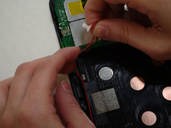

      • Using needle-nose tweezers, carefully push the small white wire connector (red/black wires) out of its housing.
      • Gently remove red/black wire strands from the clips holding them to the back of the screen.

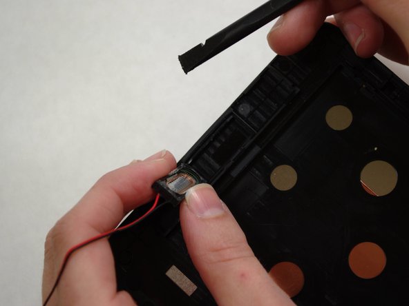

      • Gently pry audio module from the back of the screen using tweezers and spudger. Be careful not to pull on the wires.
      • Adhesive on the bottom of the speaker module may make it difficult to remove.
      • Set the audio module and attached wire aside.

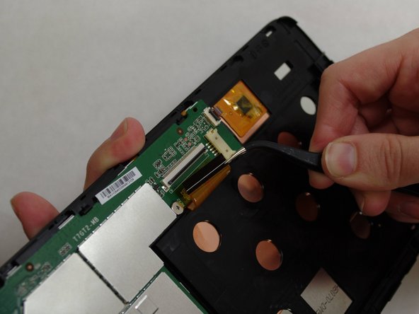

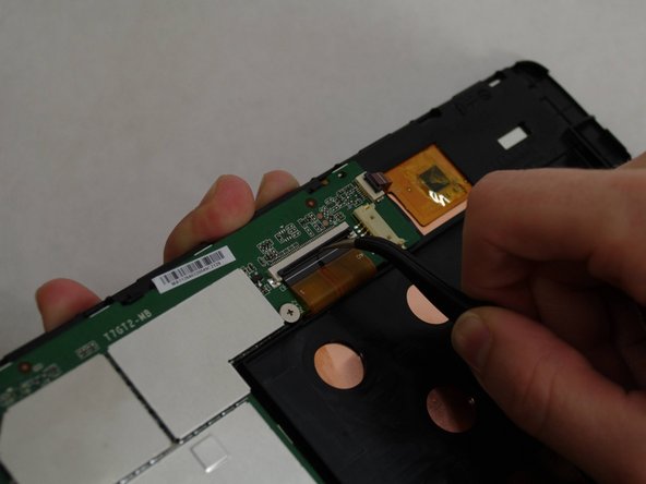

      • Using needle-nose tweezers, carefully flip up the dark gray cover on the right of the device holding the small orange/gold ribbon in place. (It is approximately 1/4" wide.)
      • With the tweezers, carefully pull the small ribbon out of its housing. It will stay attached to the device at the other end.

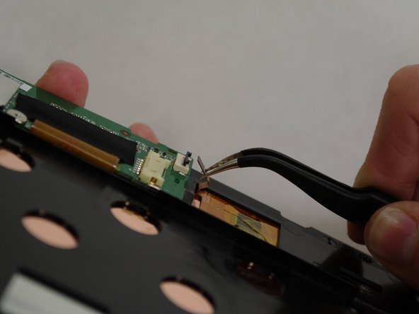

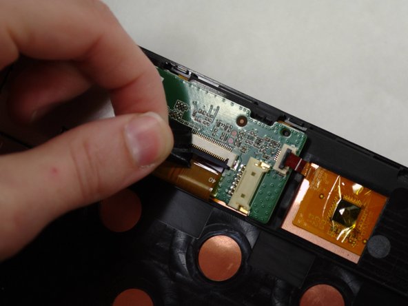

      • A wide orange/gold ribbon connects the screen to the motherboard. (Ribbon is approximately 1" wide.)
      • Carefully pull the black tape off the ribbon housing and set it aside. You will need to replace the tape when reassembling the device.
    5. Toshiba Encore Mini Screen Replacement: crwdns2935265:010crwdnd2935265:01crwdnd2935265:03crwdne2935265:0 Toshiba Encore Mini Screen Replacement: crwdns2935265:010crwdnd2935265:02crwdnd2935265:03crwdne2935265:0 Toshiba Encore Mini Screen Replacement: crwdns2935265:010crwdnd2935265:03crwdnd2935265:03crwdne2935265:0

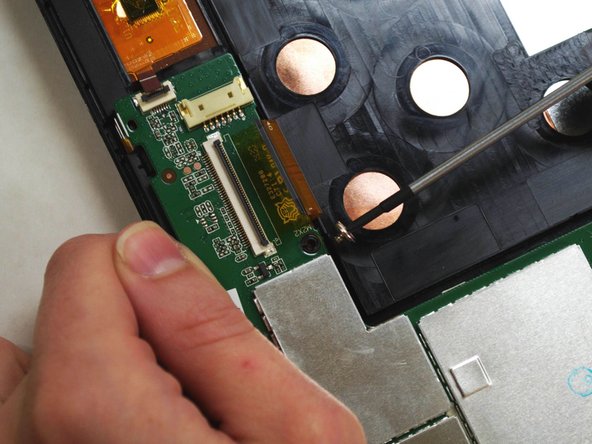

      • Damaging this ribbon will permanently disable your device!

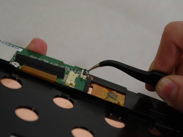

      • Using needle-nose tweezers, carefully flip up the dark gray cover.
      • With the tweezers, carefully pull the wide ribbon from its housing. It will stay attached to the device at the other end.

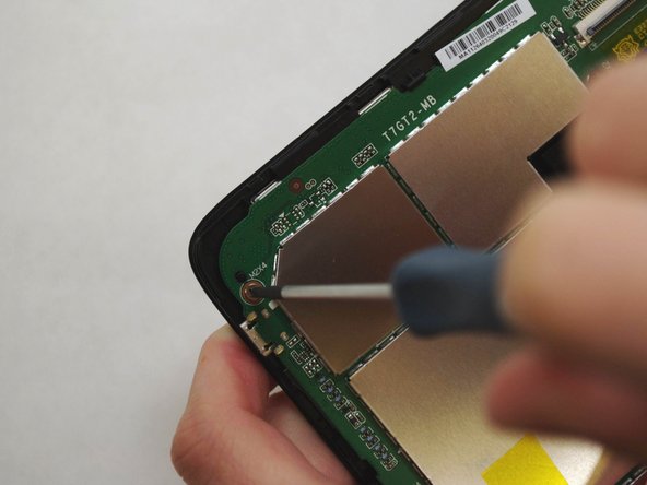

      • Using a Phillips 000 screwdriver, remove the screws holding components together.
      • Remove four 4.2 mm Phillips screws
      • Remove one 3 mm Phillips screw

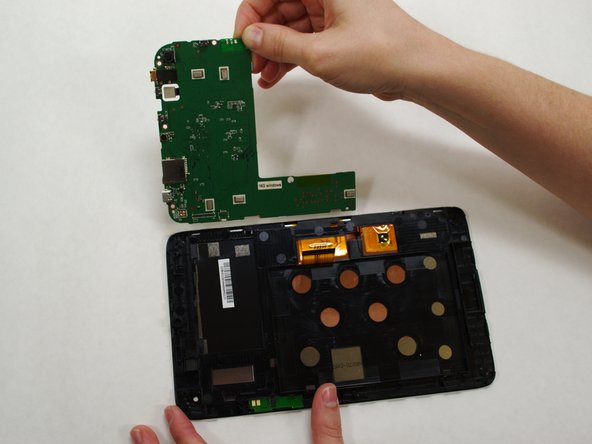

      • Holding the motherboard carefully by the edges, gently lift it up off the screen and carefully set it aside.
      • The motherboard may resist as you try to lift it --this is normal.
