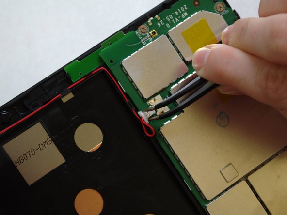

      • Using needle-nose tweezers, gently push the large white wire connector (connected to the black, red and blue wires) out of its housing.

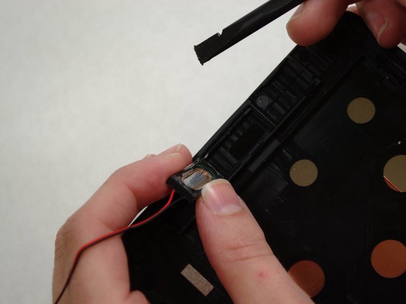

      • The audio module must be removed to replace the front-facing camera.

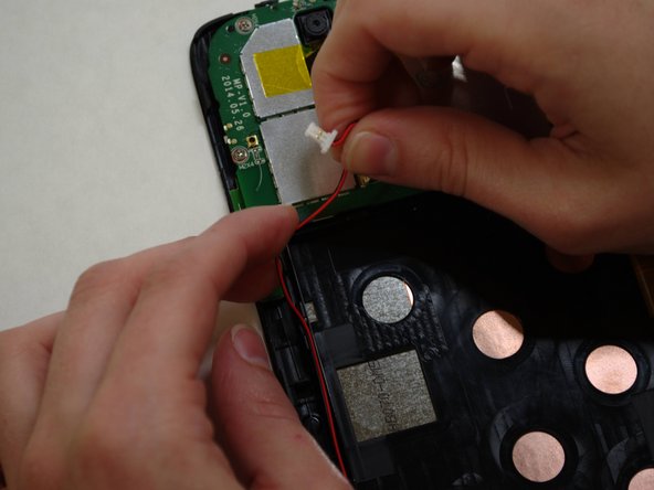

      • Using needle-nose tweezers, carefully push the small white wire connector (red/black wires) out of its housing.
      • Gently remove red/black wire strands from the clips holding them to the back of the screen.
    2. Toshiba Encore Mini Front-Facing Camera Replacement: crwdns2935265:07crwdnd2935265:01crwdnd2935265:02crwdne2935265:0 Toshiba Encore Mini Front-Facing Camera Replacement: crwdns2935265:07crwdnd2935265:02crwdnd2935265:02crwdne2935265:0
      • Gently pry audio module from the back of the screen using tweezers and spudger. Be careful not to pull on the wires.
      • Adhesive on the bottom of the speaker module may make it difficult to remove.
      • Set the audio module and attached wire aside.

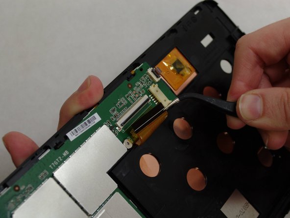

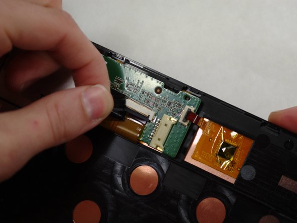

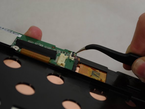

      • Using needle-nose tweezers, carefully flip up the dark gray cover on the right of the device holding the small orange ribbon in place. (It is approximately 1/4" wide.)
      • With the tweezers, carefully pull the small ribbon out of its housing. It will stay attached to the device at the other end.
    4. Toshiba Encore Mini Front-Facing Camera Replacement: crwdns2935265:09crwdnd2935265:01crwdnd2935265:02crwdne2935265:0 Toshiba Encore Mini Front-Facing Camera Replacement: crwdns2935265:09crwdnd2935265:02crwdnd2935265:02crwdne2935265:0

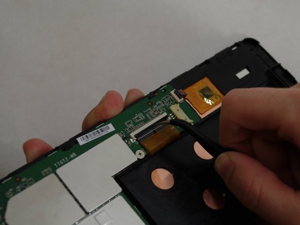

      • A wide orange/gold ribbon connects the screen to the motherboard. (Ribbon is approximately 1" wide.)
      • Carefully pull the black tape off the ribbon housing and set it aside. You will need to replace the tape when reassembling the device.

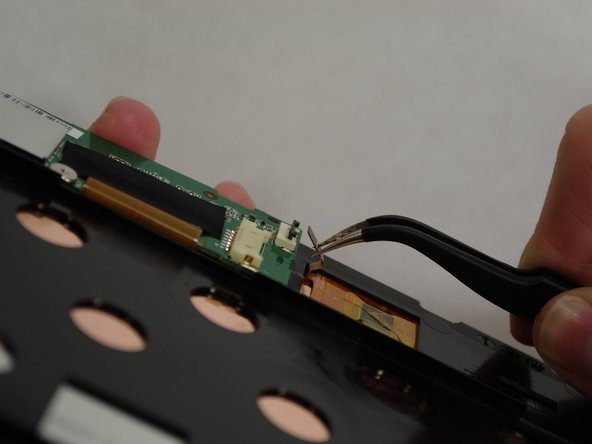

    5. Toshiba Encore Mini Front-Facing Camera Replacement: crwdns2935265:010crwdnd2935265:01crwdnd2935265:03crwdne2935265:0 Toshiba Encore Mini Front-Facing Camera Replacement: crwdns2935265:010crwdnd2935265:02crwdnd2935265:03crwdne2935265:0 Toshiba Encore Mini Front-Facing Camera Replacement: crwdns2935265:010crwdnd2935265:03crwdnd2935265:03crwdne2935265:0
      • Damaging this ribbon will permanently disable your device!
      • Using needle-nose tweezers, carefully flip up the dark gray cover.
      • With the tweezers, carefully pull the wide ribbon from its housing. It will stay attached to the device at the other end.

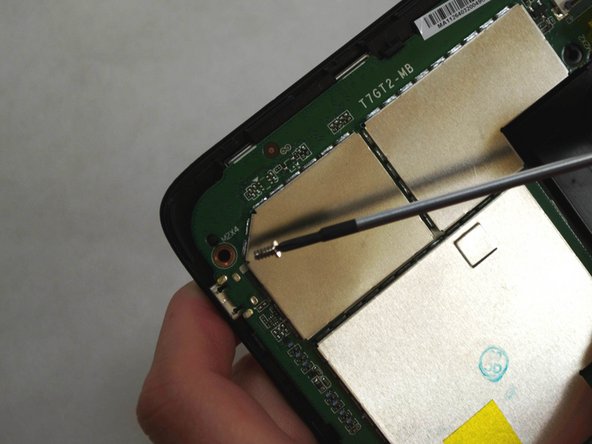

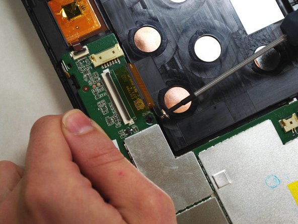

      • Using a Phillips 000 screwdriver, remove the screws holding components together.
      • Remove four 4.2 mm Phillips screws.
      • Remove one 3mm Phillips screw.

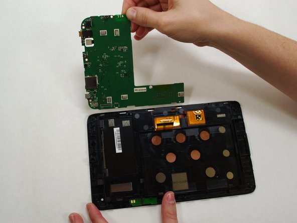

    7. Toshiba Encore Mini Front-Facing Camera Replacement: crwdns2935265:012crwdnd2935265:01crwdnd2935265:02crwdne2935265:0 Toshiba Encore Mini Front-Facing Camera Replacement: crwdns2935265:012crwdnd2935265:02crwdnd2935265:02crwdne2935265:0
      • Holding the motherboard carefully by the edges, gently lift it up off the screen and carefully set it aside.
      • The motherboard may resist as you try to lift it --this is normal.
    8. Toshiba Encore Mini Front-Facing Camera Replacement: crwdns2935265:013crwdnd2935265:01crwdnd2935265:02crwdne2935265:0 Toshiba Encore Mini Front-Facing Camera Replacement: crwdns2935265:013crwdnd2935265:02crwdnd2935265:02crwdne2935265:0

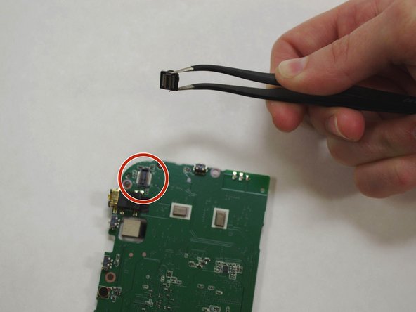

      • The front-facing camera may dislodge freely when removing the motherboard.
      • If camera has not already "popped" off the motherboard, use needle-nose tweezers to gently grasp the camera and remove from motherboard.
