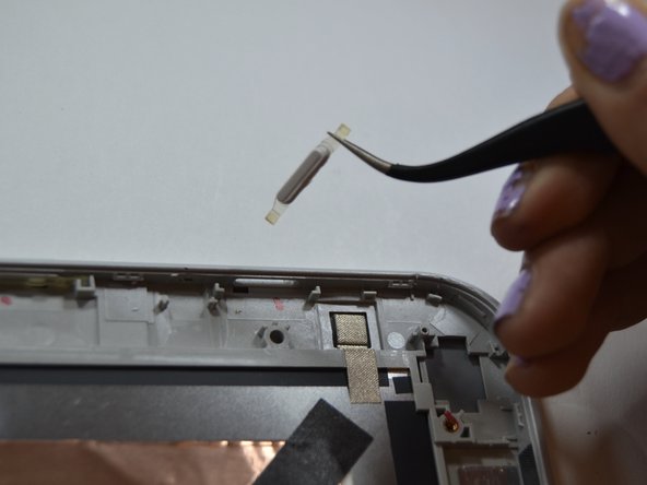

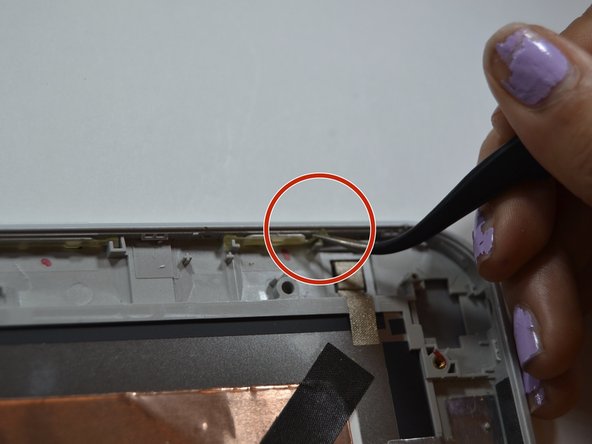

    • Once motherboard is disconnected, grab tweezers.
    • Start by locating the power button. Once it is located, with the tweezers, on the right top corner, start by lifting the plastic band upwards that is connected to the power button.
    • Grab right end of the plastic band and lift upwards to disconnect from compartment
