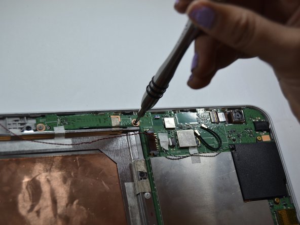

    • Once you take off the back case and battery, set tablet screen faced down.
    • Unscrew the 11 screws shown in the markups with a Phillips #00 screwdriver.
    • BE AWARE: Screws are extremely small.

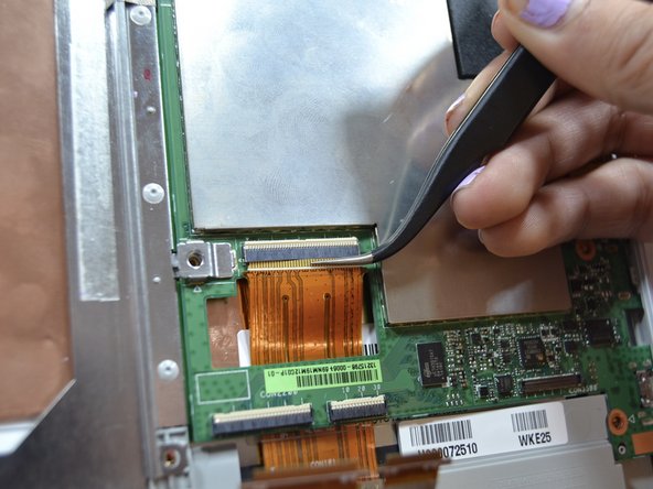

  8. Toshiba Encore 2 WT10-A Motherboard Replacement: crwdns2935265:08crwdnd2935265:01crwdnd2935265:03crwdne2935265:0 Toshiba Encore 2 WT10-A Motherboard Replacement: crwdns2935265:08crwdnd2935265:02crwdnd2935265:03crwdne2935265:0 Toshiba Encore 2 WT10-A Motherboard Replacement: crwdns2935265:08crwdnd2935265:03crwdnd2935265:03crwdne2935265:0
    • Before taking off motherboard, grab tweezers to peel off tape on the two ribbons marked on the picture.
    • Once tape is removed, use the same tweezers to carefully pull the ribbons downwards to disconnect from motherboard.

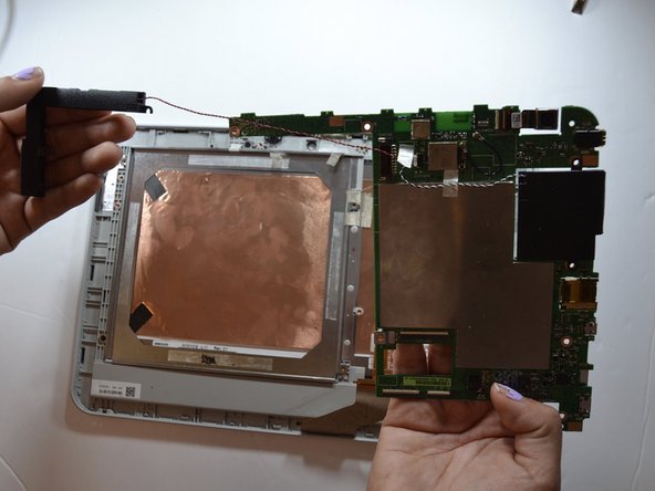

  9. Toshiba Encore 2 WT10-A Motherboard Replacement: crwdns2935265:09crwdnd2935265:01crwdnd2935265:01crwdne2935265:0
    • On the top left corner, pull the black compartment carefully upwards.
    • This component still has wires attached, so be careful not to sever the wires as you remove it.
  10. Toshiba Encore 2 WT10-A Motherboard Replacement: crwdns2935265:010crwdnd2935265:01crwdnd2935265:02crwdne2935265:0 Toshiba Encore 2 WT10-A Motherboard Replacement: crwdns2935265:010crwdnd2935265:02crwdnd2935265:02crwdne2935265:0
    • Once black compartment is off, you will be prepared to disconnect motherboard.
    • Carefully lift motherboard upwards with the black compartment.
