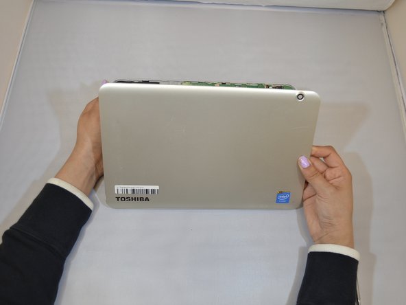

    • Start by holding your Toshiba tablet faced up.
    • Flip the tablet from left to right so that you are able to see the back of the tablet.
    • Hold tablet and be ready to continue onto the next steps.

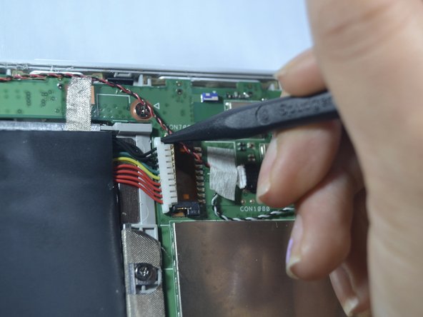

  4. Toshiba Encore 2 WT10-A Battery Replacement: crwdns2935265:04crwdnd2935265:01crwdnd2935265:02crwdne2935265:0 Toshiba Encore 2 WT10-A Battery Replacement: crwdns2935265:04crwdnd2935265:02crwdnd2935265:02crwdne2935265:0
    • Use plastic spudger to remove the attached battery wires by pushing the plastic wire holder from right to left on top and bottom part of plastic holder.

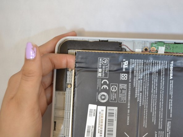

  5. Toshiba Encore 2 WT10-A Battery Replacement: crwdns2935265:05crwdnd2935265:01crwdnd2935265:03crwdne2935265:0 Toshiba Encore 2 WT10-A Battery Replacement: crwdns2935265:05crwdnd2935265:02crwdnd2935265:03crwdne2935265:0 Toshiba Encore 2 WT10-A Battery Replacement: crwdns2935265:05crwdnd2935265:03crwdnd2935265:03crwdne2935265:0
    • Start by using your left hand on the top left corner on the battery.
    • Then, begin to lift and work your way around the battery.
  6. Toshiba Encore 2 WT10-A Battery Replacement: crwdns2935265:06crwdnd2935265:01crwdnd2935265:02crwdne2935265:0 Toshiba Encore 2 WT10-A Battery Replacement: crwdns2935265:06crwdnd2935265:02crwdnd2935265:02crwdne2935265:0
    • Remove the battery from the compartment.
