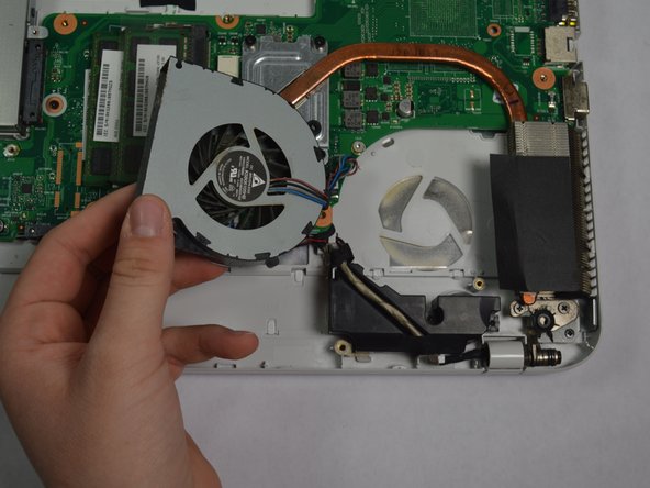

    • Gently lift the fan away from the base. There should be three wires that are connected to the base of the computer through a port.
  10. Toshiba Dynabook T552-58G Fan Replacement: crwdns2935265:010crwdnd2935265:01crwdnd2935265:01crwdne2935265:0
    • With your fingers, carefully pinch the white connector and pull up.
    • There will be some resistance.
  11. Toshiba Dynabook T552-58G Fan Replacement: crwdns2935265:011crwdnd2935265:01crwdnd2935265:01crwdne2935265:0
    • Remove the faulty fan.
