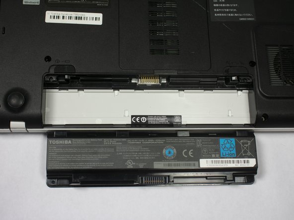

    • Flip the computer so that the back panel is facing you.
  2. Toshiba Dynabook T552-58G Battery Replacement: crwdns2935265:02crwdnd2935265:01crwdnd2935265:02crwdne2935265:0 Toshiba Dynabook T552-58G Battery Replacement: crwdns2935265:02crwdnd2935265:02crwdnd2935265:02crwdne2935265:0
    • Push the right battery cover lock (labeled as number 1) to the right.
    • It should now be on the unlock symbol.
  3. Toshiba Dynabook T552-58G Battery Replacement: crwdns2935265:03crwdnd2935265:01crwdnd2935265:01crwdne2935265:0
    • Push and hold the left battery cover lock (labeled as number 2) to the left.
    • It should now be on the number 2.
  4. Toshiba Dynabook T552-58G Battery Replacement: crwdns2935265:04crwdnd2935265:01crwdnd2935265:02crwdne2935265:0 Toshiba Dynabook T552-58G Battery Replacement: crwdns2935265:04crwdnd2935265:02crwdnd2935265:02crwdne2935265:0
    • While holding the left battery cover lock, pull up on the indent found in the center of the battery pack.
    • Lift up on the battery pack to remove it from computer.
