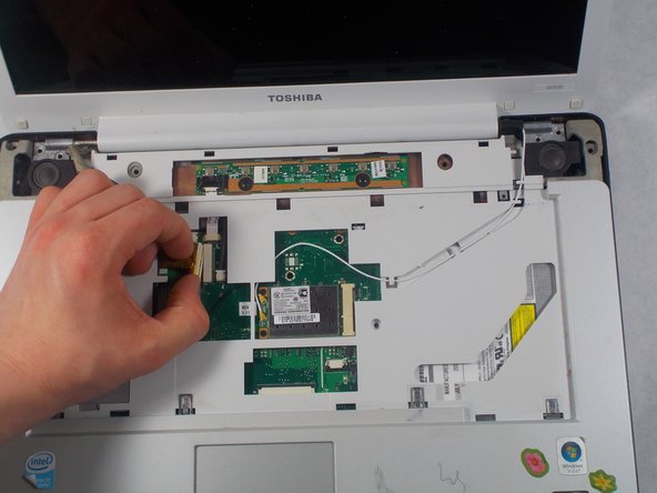

    • Pop out the black plastic tab on either side of the ribbon cable. Holding the cable on each side, detach from laptop.
  7. Toshiba Dynabook AX 53D Touchpad Replacement, Touchpad: crwdns2935265:07crwdnd2935265:01crwdnd2935265:02crwdne2935265:0 Toshiba Dynabook AX 53D Touchpad Replacement, Touchpad: crwdns2935265:07crwdnd2935265:02crwdnd2935265:02crwdne2935265:0

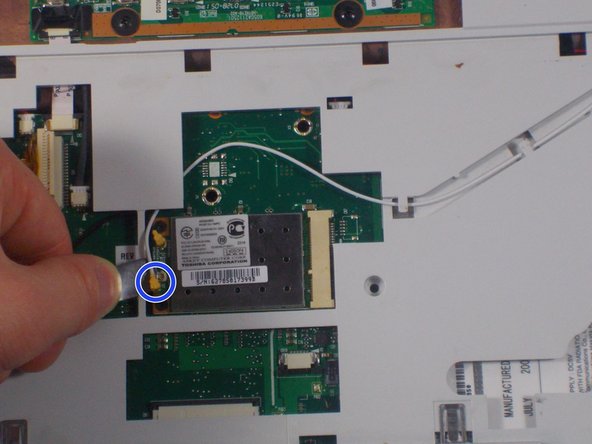

    • Detach the white plastic end of the braided LCD cable.
  8. Toshiba Dynabook AX 53D Touchpad Replacement: crwdns2935265:08crwdnd2935265:01crwdnd2935265:02crwdne2935265:0 Toshiba Dynabook AX 53D Touchpad Replacement: crwdns2935265:08crwdnd2935265:02crwdnd2935265:02crwdne2935265:0
    • Using the flat metal spatula tool, detach the thin white and black wires from their pop connectors.
