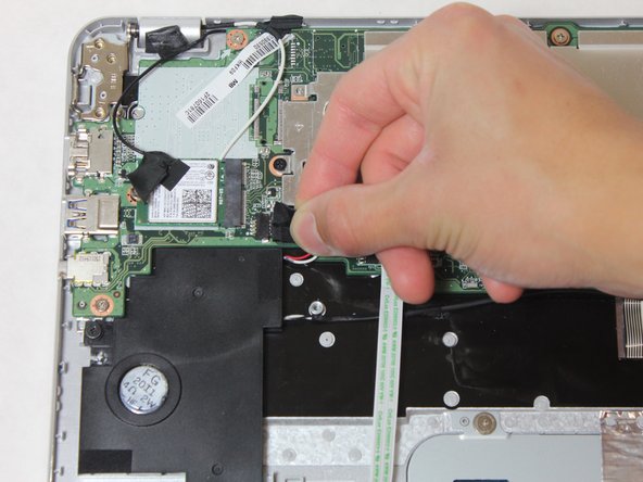

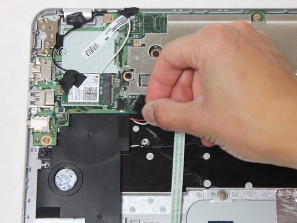

  12. Toshiba Chromebook 2 Touchpad Replacement, Touchpad: crwdns2935265:012crwdnd2935265:01crwdnd2935265:02crwdne2935265:0 Toshiba Chromebook 2 Touchpad Replacement, Touchpad: crwdns2935265:012crwdnd2935265:02crwdnd2935265:02crwdne2935265:0
    • Detach the ribbon cable connected to the motherboard by gently pulling near the top fold.

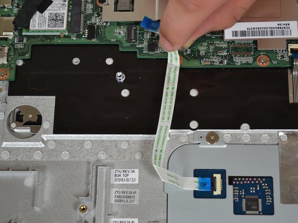

  13. Toshiba Chromebook 2 Touchpad Replacement: crwdns2935265:013crwdnd2935265:01crwdnd2935265:01crwdne2935265:0
    • Detach the ribbon cable connected to the touch pad by gently pulling near the bottom fold.

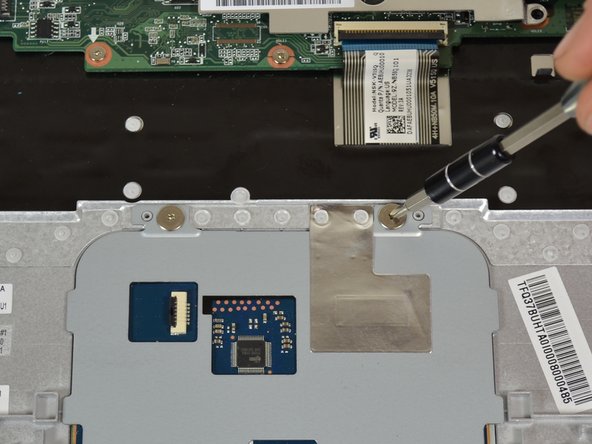

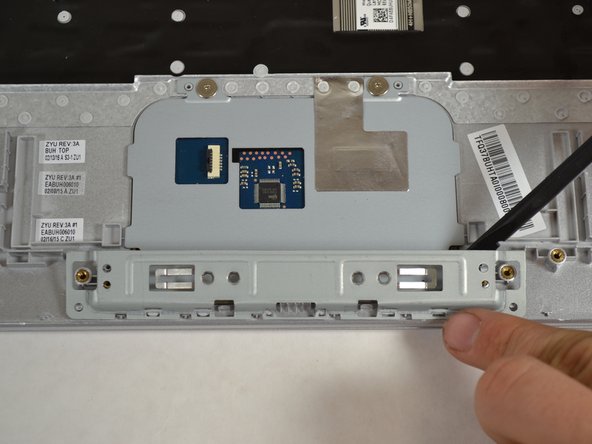

  14. Toshiba Chromebook 2 Touchpad Replacement: crwdns2935265:014crwdnd2935265:01crwdnd2935265:02crwdne2935265:0 Toshiba Chromebook 2 Touchpad Replacement: crwdns2935265:014crwdnd2935265:02crwdnd2935265:02crwdne2935265:0
    • Remove all four 3.70mm screws around the edges of the touchpad using a Phillips #0 screwdriver.
  15. Toshiba Chromebook 2 Touchpad Replacement: crwdns2935265:015crwdnd2935265:01crwdnd2935265:02crwdne2935265:0 Toshiba Chromebook 2 Touchpad Replacement: crwdns2935265:015crwdnd2935265:02crwdnd2935265:02crwdne2935265:0
    • Use the spudger to push up on the metal cover below the touch pad until it reaches 90 degrees then pull up to detach.

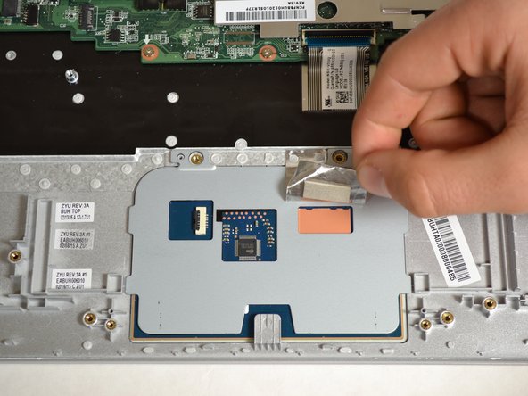

  16. Toshiba Chromebook 2 Touchpad Replacement: crwdns2935265:016crwdnd2935265:01crwdnd2935265:03crwdne2935265:0 Toshiba Chromebook 2 Touchpad Replacement: crwdns2935265:016crwdnd2935265:02crwdnd2935265:03crwdne2935265:0 Toshiba Chromebook 2 Touchpad Replacement: crwdns2935265:016crwdnd2935265:03crwdnd2935265:03crwdne2935265:0

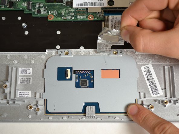

    • Peel back the aluminum foil piece on the top right corner of the touchpad.
    • Move slowly and carefully, you will need the same aluminum foil piece to connect to your new touchpad.

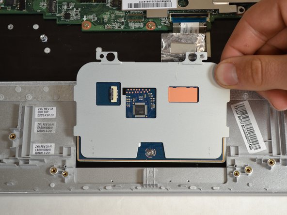

  17. Toshiba Chromebook 2 Touchpad Replacement: crwdns2935265:017crwdnd2935265:01crwdnd2935265:02crwdne2935265:0 Toshiba Chromebook 2 Touchpad Replacement: crwdns2935265:017crwdnd2935265:02crwdnd2935265:02crwdne2935265:0
    • Push down on the bottom right corner and slowly lift up in the upper right hand corner until the touch pad comes out.
