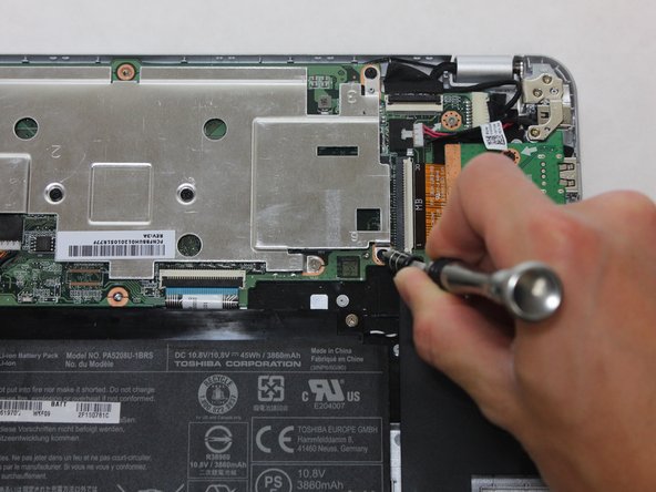

  6. Toshiba Chromebook 2 Motherboard Replacement, Motherboard: crwdns2935265:06crwdnd2935265:01crwdnd2935265:02crwdne2935265:0 Toshiba Chromebook 2 Motherboard Replacement, Motherboard: crwdns2935265:06crwdnd2935265:02crwdnd2935265:02crwdne2935265:0
    • Remove the 14 Phillips 2.34mm screws using the Phillips #0 screwdriver.

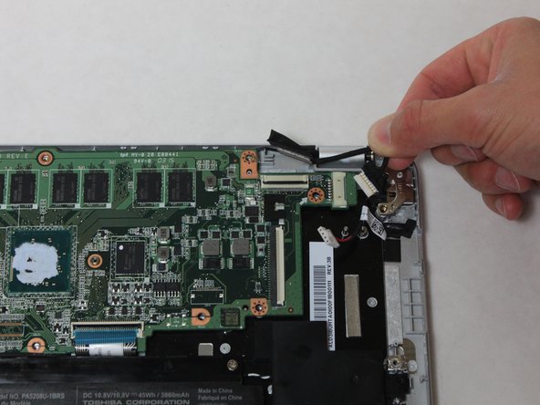

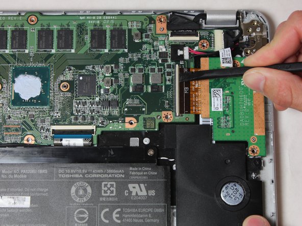

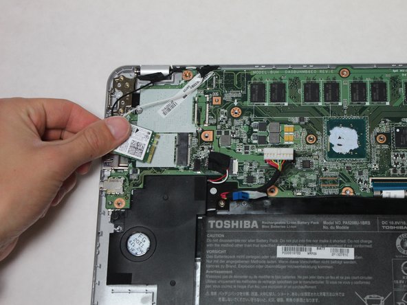

  8. Toshiba Chromebook 2 Motherboard Replacement: crwdns2935265:08crwdnd2935265:01crwdnd2935265:03crwdne2935265:0 Toshiba Chromebook 2 Motherboard Replacement: crwdns2935265:08crwdnd2935265:02crwdnd2935265:03crwdne2935265:0 Toshiba Chromebook 2 Motherboard Replacement: crwdns2935265:08crwdnd2935265:03crwdnd2935265:03crwdne2935265:0
    • Flip up the plastic clamps holding down the 4 ribbon cables connected to the motherboard while gently pulling the ribbon cables from the sockets.

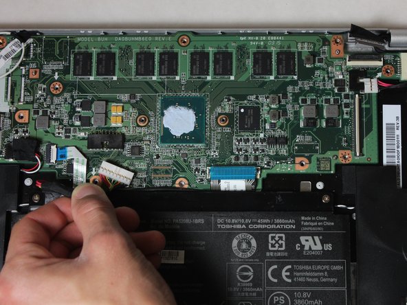

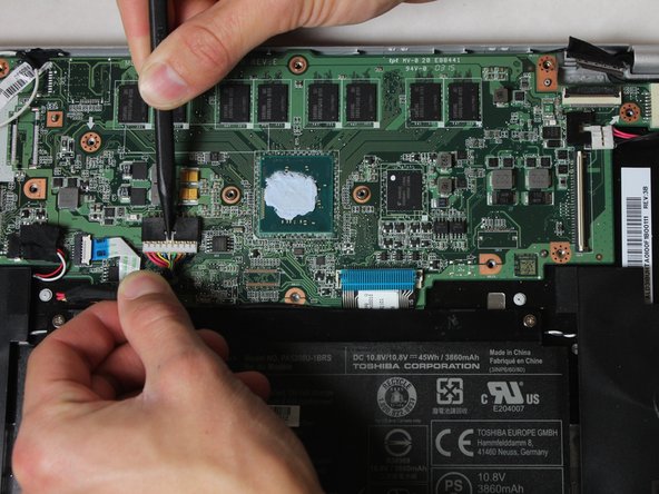

  9. Toshiba Chromebook 2 Motherboard Replacement: crwdns2935265:09crwdnd2935265:01crwdnd2935265:03crwdne2935265:0 Toshiba Chromebook 2 Motherboard Replacement: crwdns2935265:09crwdnd2935265:02crwdnd2935265:03crwdne2935265:0 Toshiba Chromebook 2 Motherboard Replacement: crwdns2935265:09crwdnd2935265:03crwdnd2935265:03crwdne2935265:0
    • Use the spudger to press down on the 2 white port cables, while also pulling each white port cable out of their sockets.

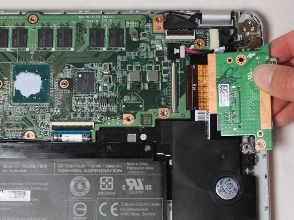

  10. Toshiba Chromebook 2 Motherboard Replacement: crwdns2935265:010crwdnd2935265:01crwdnd2935265:03crwdne2935265:0 Toshiba Chromebook 2 Motherboard Replacement: crwdns2935265:010crwdnd2935265:02crwdnd2935265:03crwdne2935265:0 Toshiba Chromebook 2 Motherboard Replacement: crwdns2935265:010crwdnd2935265:03crwdnd2935265:03crwdne2935265:0
    • Disconnect the motherboard from the 3 remaining cables by pulling the chords out of the sockets.

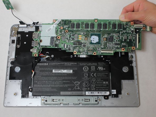

  11. Toshiba Chromebook 2 Motherboard Replacement: crwdns2935265:011crwdnd2935265:01crwdnd2935265:02crwdne2935265:0 Toshiba Chromebook 2 Motherboard Replacement: crwdns2935265:011crwdnd2935265:02crwdnd2935265:02crwdne2935265:0
    • Remove the motherboard by pulling upward and to the right.
    • Be careful not to damage the ports located on the left side of the motherboard during removal.
