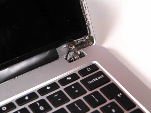

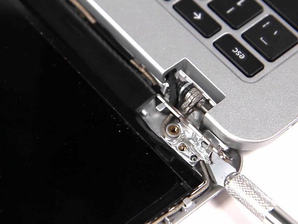

    • Remove the two screws holding the back assembly to the hinge mechanism.
    • Be careful as you're unscrewing these! Support the display assembly with your other hand.
    • Lay the loose display assembly down and then fold the metal foil tabs up and out of the way.
    • Some models' screens are held down by adhesive; if this is the case with yours, carefully pry the screen away from the back being careful not to damage any cables.
    • If your display is screwed down, there will be extra screws to remove and it should then come away freely.

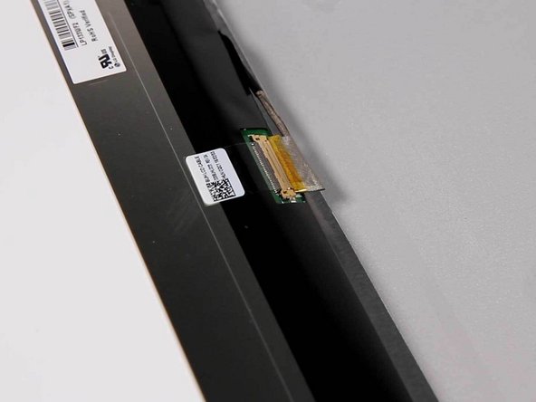

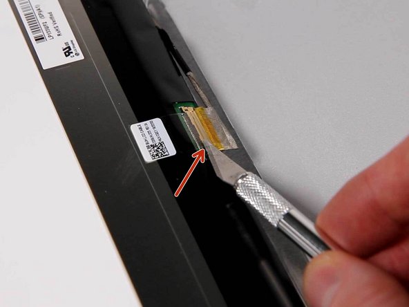

  4. Toshiba Chromebook 2 LCD Screen Replacement: crwdns2935265:04crwdnd2935265:01crwdnd2935265:03crwdne2935265:0 Toshiba Chromebook 2 LCD Screen Replacement: crwdns2935265:04crwdnd2935265:02crwdnd2935265:03crwdne2935265:0 Toshiba Chromebook 2 LCD Screen Replacement: crwdns2935265:04crwdnd2935265:03crwdnd2935265:03crwdne2935265:0
    • Fold the loose screen down onto the laptop's keyboard, as if you were closing the laptop, with the rear of the display assembly still open.
    • Carefully remove the connecting ribbon cable as shown in the picture.
    • You may need to remove the sticky adhesive tape which holds the connector in place before you can remove it.
    • When reassembling, replace this with some fresh sticky table to help prevent it coming loose over time.
