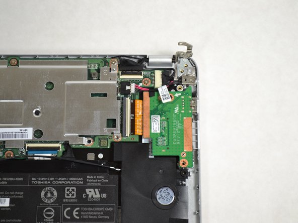

  6. Toshiba Chromebook 2 Charging Port Replacement, Charging Port: crwdns2935265:06crwdnd2935265:01crwdnd2935265:01crwdne2935265:0
    • The changing port is located on the left side of the computer, when flipped over and the back cover is taken off, the port will be in the top right corner.
    • In order to access the port, the metal hinge in the top right corner must be lifted up.

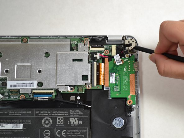

  7. Toshiba Chromebook 2 Charging Port Replacement: crwdns2935265:07crwdnd2935265:01crwdnd2935265:03crwdne2935265:0 Toshiba Chromebook 2 Charging Port Replacement: crwdns2935265:07crwdnd2935265:02crwdnd2935265:03crwdne2935265:0 Toshiba Chromebook 2 Charging Port Replacement: crwdns2935265:07crwdnd2935265:03crwdnd2935265:03crwdne2935265:0
    • Pry the metal hinge up with the spudger tool by sticking the flat end under the bottom of the hinge and leverage it up.
    • Open the hinge all the way until it is sticking straight up.
  8. Toshiba Chromebook 2 Charging Port Replacement: crwdns2935265:08crwdnd2935265:01crwdnd2935265:02crwdne2935265:0 Toshiba Chromebook 2 Charging Port Replacement: crwdns2935265:08crwdnd2935265:02crwdnd2935265:02crwdne2935265:0
    • Press down on the white clip with the pointed side of the spudger tool and softly pull the wires out of the socket by pulling horizontally away from the clip to disconnect the charging port from the motherboard.
  9. Toshiba Chromebook 2 Charging Port Replacement: crwdns2935265:09crwdnd2935265:01crwdnd2935265:01crwdne2935265:0
    • Pull the charging port out by pulling up on the cable that connects the port to the motherboard.
