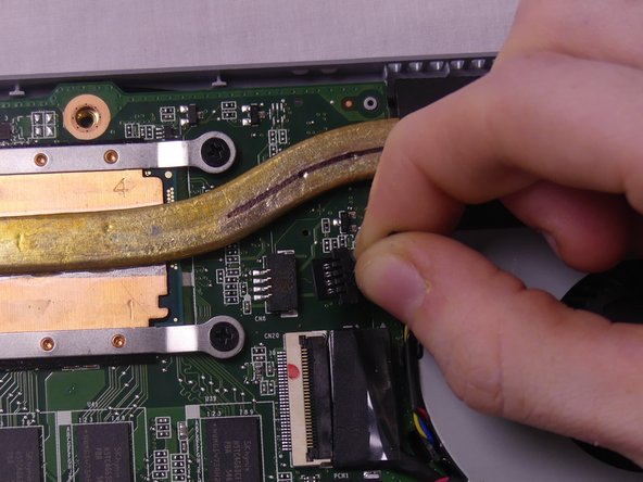

  10. Toshiba CB35-C3300 Chromebook 2 WiFi PCB Replacement: crwdns2935265:010crwdnd2935265:01crwdnd2935265:01crwdne2935265:0
    • Unscrew the 4 Phillip screws using a Phillips # 1 Screwdriver.
    • These screws only loosen partially, they do not disconnect.

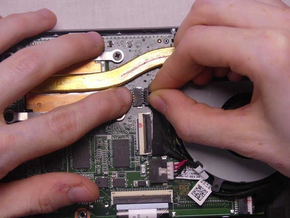

  11. Toshiba CB35-C3300 Chromebook 2 WiFi PCB Replacement: crwdns2935265:011crwdnd2935265:01crwdnd2935265:03crwdne2935265:0 Toshiba CB35-C3300 Chromebook 2 WiFi PCB Replacement: crwdns2935265:011crwdnd2935265:02crwdnd2935265:03crwdne2935265:0 Toshiba CB35-C3300 Chromebook 2 WiFi PCB Replacement: crwdns2935265:011crwdnd2935265:03crwdnd2935265:03crwdne2935265:0

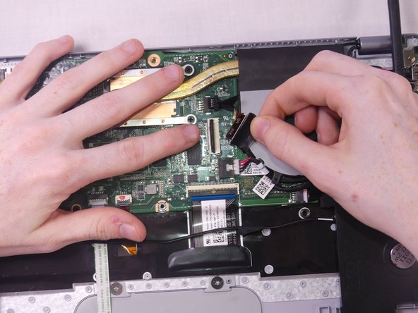

    • The top wire is the fan's wire. Remove it by pulling it from the motherboard.

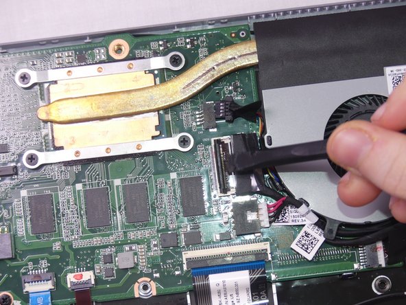

    • To remove the Wifi PCB wire lift up the hinged flap with your finger or with the aid of the spudger tool.
    • After the flap is lifted, pull the wire up out of the connector socket.

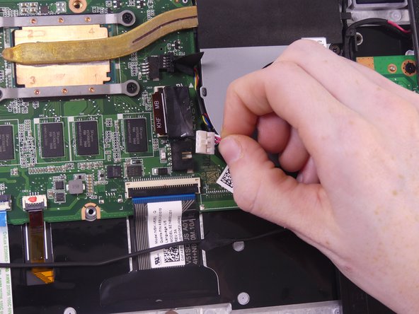

  13. Toshiba CB35-C3300 Chromebook 2 WiFi PCB Replacement: crwdns2935265:013crwdnd2935265:01crwdnd2935265:02crwdne2935265:0 Toshiba CB35-C3300 Chromebook 2 WiFi PCB Replacement: crwdns2935265:013crwdnd2935265:02crwdnd2935265:02crwdne2935265:0
    • Remove the headphone jack wire by pulling it out of the connector socket.

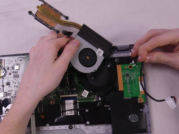

  15. Toshiba CB35-C3300 Chromebook 2 WiFi PCB Replacement: crwdns2935265:015crwdnd2935265:01crwdnd2935265:01crwdne2935265:0
    • Lift up on the metal plate that hold the screws to start removing the fan.

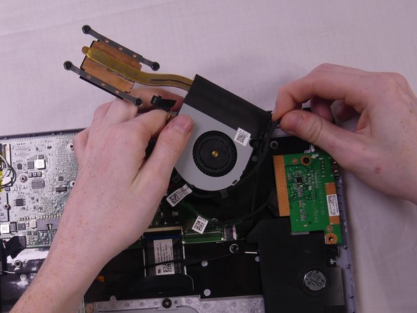

  16. Toshiba CB35-C3300 Chromebook 2 WiFi PCB Replacement: crwdns2935265:016crwdnd2935265:01crwdnd2935265:03crwdne2935265:0 Toshiba CB35-C3300 Chromebook 2 WiFi PCB Replacement: crwdns2935265:016crwdnd2935265:02crwdnd2935265:03crwdne2935265:0 Toshiba CB35-C3300 Chromebook 2 WiFi PCB Replacement: crwdns2935265:016crwdnd2935265:03crwdnd2935265:03crwdne2935265:0
    • Once lifted, you will notice that there are two wires tucked under plastic tunnels on the right side of the fan. Remove these wires.
    • These wires require you to gently pull them out of there tunnel.
    • Once the wires are removed the fan should be removed entirely.

The article has some mistakes, namely, this isn’t the WiFi / WLAN, it is a USB port and card reader slot PCB. I came to iFixIt to double-check the part to upgrade to WiFi 6 (ax). Once you fix the part name, the article is good! The part number DA0BUITH8D0 is what to search for when trying to buy one. I didn’t need one, but looked it up just the same, there are not a ton of these out there and I would probably just resort to a USB reader.
