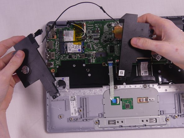

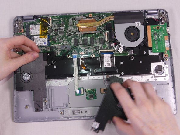

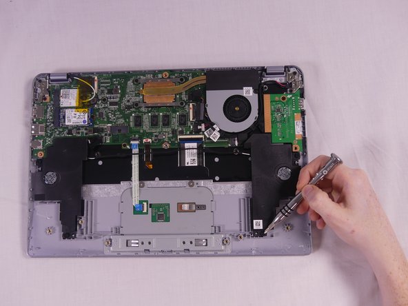

  9. Toshiba CB35-C3300 Chromebook 2 Speakers, Speakers: crwdns2935265:09crwdnd2935265:01crwdnd2935265:02crwdne2935265:0 Toshiba CB35-C3300 Chromebook 2 Speakers, Speakers: crwdns2935265:09crwdnd2935265:02crwdnd2935265:02crwdne2935265:0
    • Remove the 4 Phillip 6.3 mm screws from both the right and left speakers using Phllips 1 screwdriver.
  10. Toshiba CB35-C3300 Chromebook 2 Speakers: crwdns2935265:010crwdnd2935265:01crwdnd2935265:01crwdne2935265:0
    • Gently remove wire from the motherboard by pulling it out of the connector socket.
  11. Toshiba CB35-C3300 Chromebook 2 Speakers: crwdns2935265:011crwdnd2935265:01crwdnd2935265:03crwdne2935265:0 Toshiba CB35-C3300 Chromebook 2 Speakers: crwdns2935265:011crwdnd2935265:02crwdnd2935265:03crwdne2935265:0 Toshiba CB35-C3300 Chromebook 2 Speakers: crwdns2935265:011crwdnd2935265:03crwdnd2935265:03crwdne2935265:0
    • Remove the right and left speaker by lifting them up.
