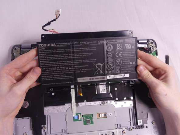

  8. Toshiba CB35-C3300 Chromebook 2 Battery  Replacement: crwdns2935265:08crwdnd2935265:01crwdnd2935265:02crwdne2935265:0 Toshiba CB35-C3300 Chromebook 2 Battery  Replacement: crwdns2935265:08crwdnd2935265:02crwdnd2935265:02crwdne2935265:0
    • Remove the battery by gently pulling on the bottom corners.
    • Be careful to move the battery's wire under the speaker's wire.
