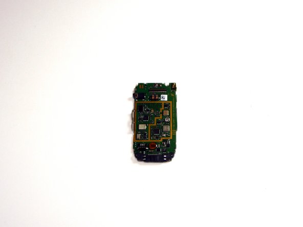

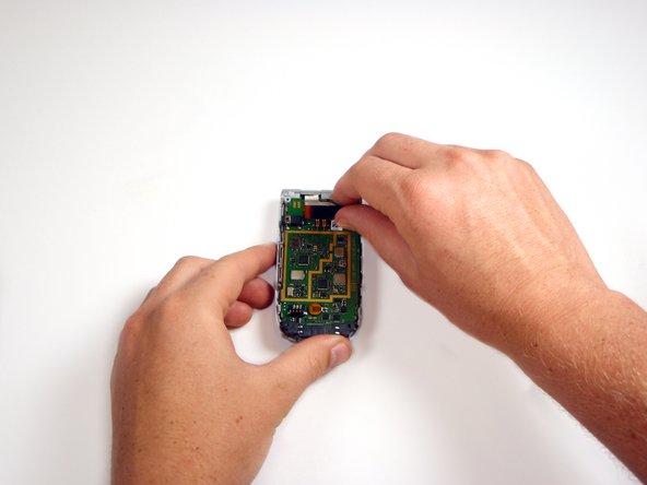

  4. Toshiba A1304T Logic Board Replacement, Logic Board: crwdns2935265:04crwdnd2935265:01crwdnd2935265:03crwdne2935265:0 Toshiba A1304T Logic Board Replacement, Logic Board: crwdns2935265:04crwdnd2935265:02crwdnd2935265:03crwdne2935265:0 Toshiba A1304T Logic Board Replacement, Logic Board: crwdns2935265:04crwdnd2935265:03crwdnd2935265:03crwdne2935265:0
    • Use your fingers to gently detach the ribbon wire from the logic board.

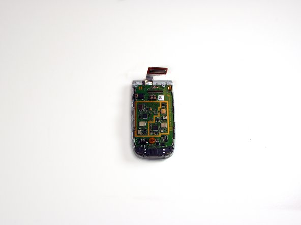

  5. Toshiba A1304T Logic Board Replacement: crwdns2935265:05crwdnd2935265:01crwdnd2935265:02crwdne2935265:0 Toshiba A1304T Logic Board Replacement: crwdns2935265:05crwdnd2935265:02crwdnd2935265:02crwdne2935265:0
    • Use the flathead screwdriver to pry the logic board and keypad from the device.

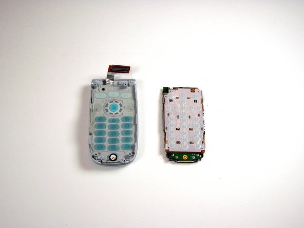

  6. Toshiba A1304T Logic Board Replacement: crwdns2935265:06crwdnd2935265:01crwdnd2935265:02crwdne2935265:0 Toshiba A1304T Logic Board Replacement: crwdns2935265:06crwdnd2935265:02crwdnd2935265:02crwdne2935265:0
    • Use your thumb to peel the keypad from the device.
