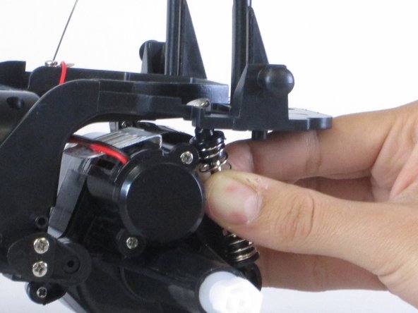

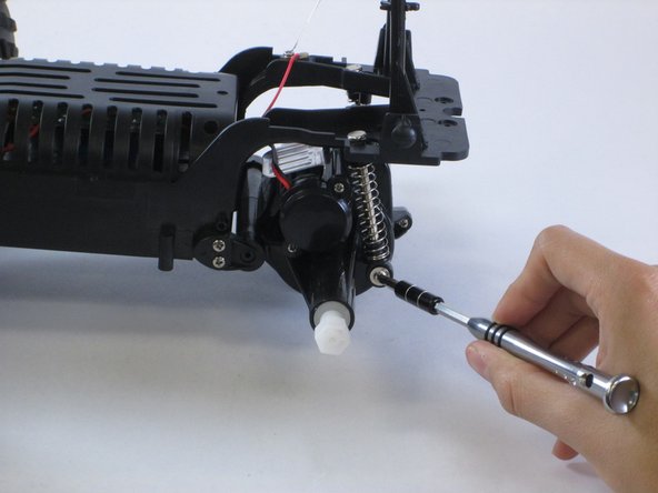

  5. Torque King Electric RTR RC Monster Truck Rear Wheel Suspension Replacement, Rear Wheel Suspension: crwdns2935265:05crwdnd2935265:01crwdnd2935265:01crwdne2935265:0
    • After removing the rear wheels, remove the 8mm screw under each spring with a Phillips 1 screwdriver.

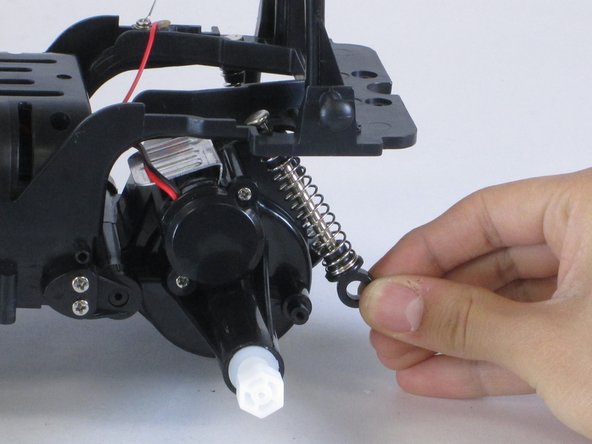

  6. Torque King Electric RTR RC Monster Truck Rear Wheel Suspension Replacement: crwdns2935265:06crwdnd2935265:01crwdnd2935265:01crwdne2935265:0
    • Slide off the bottom part of the rod connected to the chassis.

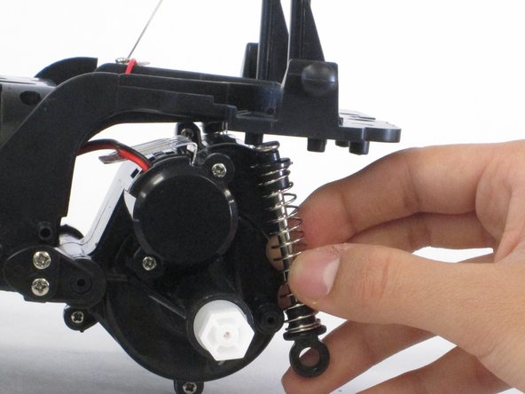

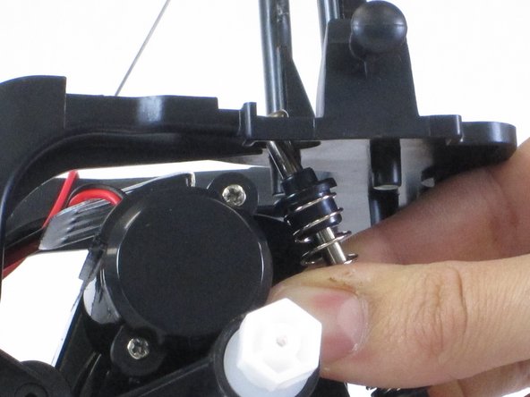

  7. Torque King Electric RTR RC Monster Truck Rear Wheel Suspension Replacement: crwdns2935265:07crwdnd2935265:01crwdnd2935265:03crwdne2935265:0 Torque King Electric RTR RC Monster Truck Rear Wheel Suspension Replacement: crwdns2935265:07crwdnd2935265:02crwdnd2935265:03crwdne2935265:0 Torque King Electric RTR RC Monster Truck Rear Wheel Suspension Replacement: crwdns2935265:07crwdnd2935265:03crwdnd2935265:03crwdne2935265:0
    • Pull the black washer inside the spring downwards and towards the truck's rear simultaneously in order to remove the suspension.
