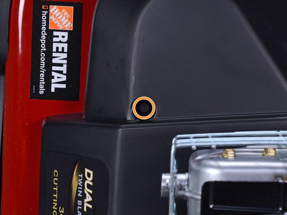

  5. Toro Walk Behind Mowers 21199HD 2018 Right Spindle Replacement, Remove the belt guard bolts: crwdns2935265:05crwdnd2935265:01crwdnd2935265:03crwdne2935265:0 Toro Walk Behind Mowers 21199HD 2018 Right Spindle Replacement, Remove the belt guard bolts: crwdns2935265:05crwdnd2935265:02crwdnd2935265:03crwdne2935265:0 Toro Walk Behind Mowers 21199HD 2018 Right Spindle Replacement, Remove the belt guard bolts: crwdns2935265:05crwdnd2935265:03crwdnd2935265:03crwdne2935265:0
    • Use a 3/8-inch socket to remove the four bolts securing the belt guard:
    • Three 1 inch-long recessed bolts
    • One 1 1/2 inch-long bolt

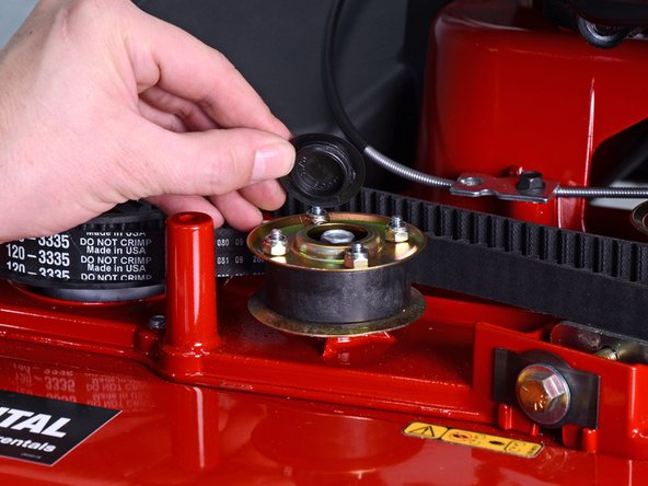

  7. Toro Walk Behind Mowers 21199HD 2018 Right Spindle Replacement, Loosen the belt tensioner: crwdns2935265:07crwdnd2935265:01crwdnd2935265:02crwdne2935265:0 Toro Walk Behind Mowers 21199HD 2018 Right Spindle Replacement, Loosen the belt tensioner: crwdns2935265:07crwdnd2935265:02crwdnd2935265:02crwdne2935265:0
    • Loosen, but don't remove, the belt tensioner to give the belt some slack.
    • Use a 1/2 inch socket and 1/2 wrench simultaneously to loosen the tensioner.

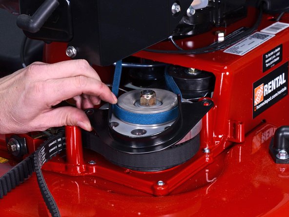

  8. Toro Walk Behind Mowers 21199HD 2018 Right Spindle Replacement, Remove the pulley plug cap: crwdns2935265:08crwdnd2935265:01crwdnd2935265:02crwdne2935265:0 Toro Walk Behind Mowers 21199HD 2018 Right Spindle Replacement, Remove the pulley plug cap: crwdns2935265:08crwdnd2935265:02crwdnd2935265:02crwdne2935265:0
    • Use a flathead screwdriver to pry off the plastic plug cap.
    • Remove the plug cap.

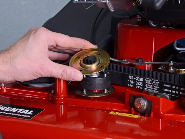

  9. Toro Walk Behind Mowers 21199HD 2018 Right Spindle Replacement, Remove the upper belt guide: crwdns2935265:09crwdnd2935265:01crwdnd2935265:01crwdne2935265:0
    • Use a 3/8 inch socket to remove the four bolts securing the upper belt guide to the pulley.
  10. Toro Walk Behind Mowers 21199HD 2018 Right Spindle Replacement: crwdns2935265:010crwdnd2935265:01crwdnd2935265:02crwdne2935265:0 Toro Walk Behind Mowers 21199HD 2018 Right Spindle Replacement: crwdns2935265:010crwdnd2935265:02crwdnd2935265:02crwdne2935265:0
    • Remove the upper belt guide from the pulley.

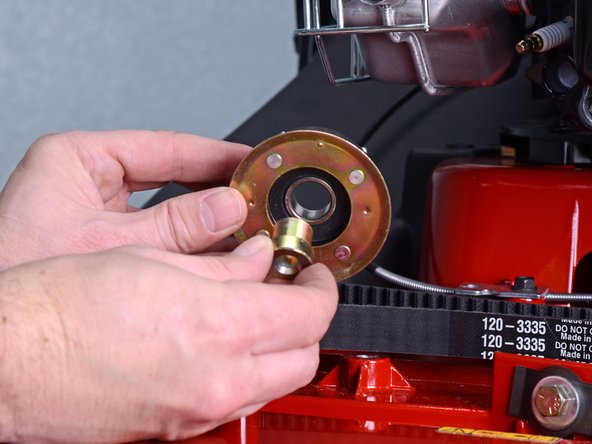

  11. Toro Walk Behind Mowers 21199HD 2018 Right Spindle Replacement, Remove the left pulley: crwdns2935265:011crwdnd2935265:01crwdnd2935265:01crwdne2935265:0
    • Use a 1/2 inch socket to remove the left pulley bolt
  12. Toro Walk Behind Mowers 21199HD 2018 Right Spindle Replacement: crwdns2935265:012crwdnd2935265:01crwdnd2935265:02crwdne2935265:0 Toro Walk Behind Mowers 21199HD 2018 Right Spindle Replacement: crwdns2935265:012crwdnd2935265:02crwdnd2935265:02crwdne2935265:0
    • Remove the pulley bolt and washer.
  13. Toro Walk Behind Mowers 21199HD 2018 Right Spindle Replacement: crwdns2935265:013crwdnd2935265:01crwdnd2935265:03crwdne2935265:0 Toro Walk Behind Mowers 21199HD 2018 Right Spindle Replacement: crwdns2935265:013crwdnd2935265:02crwdnd2935265:03crwdne2935265:0 Toro Walk Behind Mowers 21199HD 2018 Right Spindle Replacement: crwdns2935265:013crwdnd2935265:03crwdnd2935265:03crwdne2935265:0
    • Remove the left pulley.
    • Remove the bushing from the pulley.

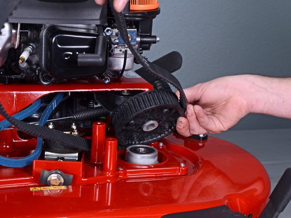

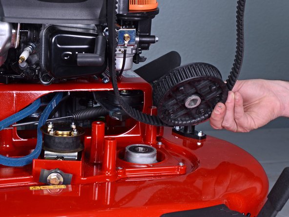

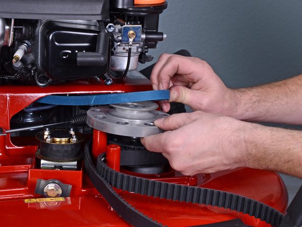

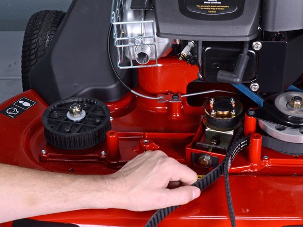

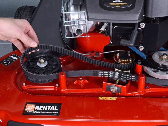

  14. Toro Walk Behind Mowers 21199HD 2018 Right Spindle Replacement, Remove the belt from the left sprocket: crwdns2935265:014crwdnd2935265:01crwdnd2935265:03crwdne2935265:0 Toro Walk Behind Mowers 21199HD 2018 Right Spindle Replacement, Remove the belt from the left sprocket: crwdns2935265:014crwdnd2935265:02crwdnd2935265:03crwdne2935265:0 Toro Walk Behind Mowers 21199HD 2018 Right Spindle Replacement, Remove the belt from the left sprocket: crwdns2935265:014crwdnd2935265:03crwdnd2935265:03crwdne2935265:0
    • Lift the belt up and over the left sprocket.
    • Move the belt to the front of the mower, out of the way of the belt tensioner.
    • During reassembly, ensure all belt teeth are fully seated, otherwise there will not be enough slack for the belt to be installed.
    • During reassembly, ensure that the blades are oriented perpendicularly to one another so they don't collide.
    • Spin the left sprocket, with the blade attached underneath, until it is in a safe position, then place the belt on the sprocket.
    • Spin both blades to ensure they don't touch during a 360˚ rotation.

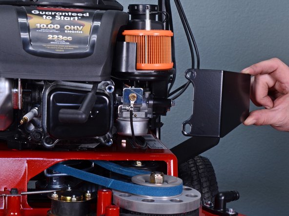

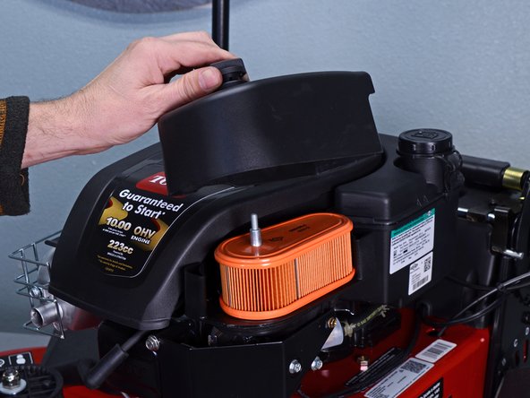

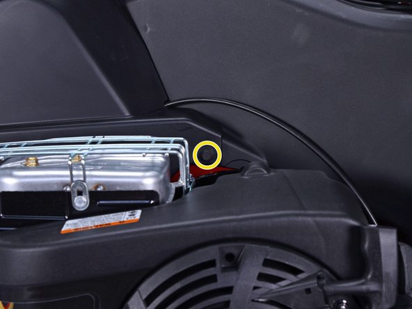

  17. Toro Walk Behind Mowers 21199HD 2018 Right Spindle Replacement, Remove the air cleaner cover: crwdns2935265:017crwdnd2935265:01crwdnd2935265:01crwdne2935265:0
    • Loosen the knob on top of the air cleaner cover, on the top side of the motor.
  18. Toro Walk Behind Mowers 21199HD 2018 Right Spindle Replacement: crwdns2935265:018crwdnd2935265:01crwdnd2935265:02crwdne2935265:0 Toro Walk Behind Mowers 21199HD 2018 Right Spindle Replacement: crwdns2935265:018crwdnd2935265:02crwdnd2935265:02crwdne2935265:0
    • Lift the cover up and off of the air cleaner to remove it.

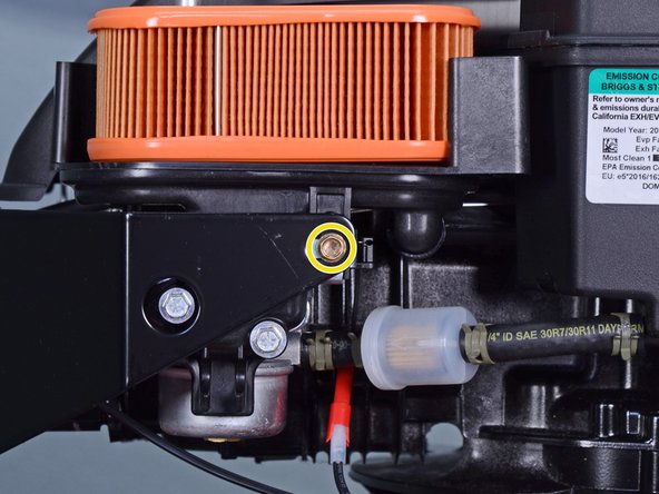

  19. Toro Walk Behind Mowers 21199HD 2018 Right Spindle Replacement, Remove the engine guard: crwdns2935265:019crwdnd2935265:01crwdnd2935265:02crwdne2935265:0 Toro Walk Behind Mowers 21199HD 2018 Right Spindle Replacement, Remove the engine guard: crwdns2935265:019crwdnd2935265:02crwdnd2935265:02crwdne2935265:0
    • Remove the three metric bolts securing the engine guard:
    • Two 10 mm bolts
    • One 8 mm bolt
  20. Toro Walk Behind Mowers 21199HD 2018 Right Spindle Replacement: crwdns2935265:020crwdnd2935265:01crwdnd2935265:02crwdne2935265:0 Toro Walk Behind Mowers 21199HD 2018 Right Spindle Replacement: crwdns2935265:020crwdnd2935265:02crwdnd2935265:02crwdne2935265:0
    • Remove the engine guard.

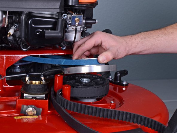

  21. Toro Walk Behind Mowers 21199HD 2018 Right Spindle Replacement, Remove the engine brake: crwdns2935265:021crwdnd2935265:01crwdnd2935265:03crwdne2935265:0 Toro Walk Behind Mowers 21199HD 2018 Right Spindle Replacement, Remove the engine brake: crwdns2935265:021crwdnd2935265:02crwdnd2935265:03crwdne2935265:0 Toro Walk Behind Mowers 21199HD 2018 Right Spindle Replacement, Remove the engine brake: crwdns2935265:021crwdnd2935265:03crwdnd2935265:03crwdne2935265:0

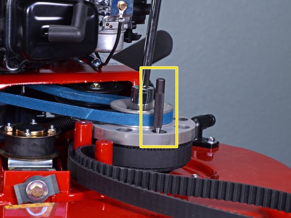

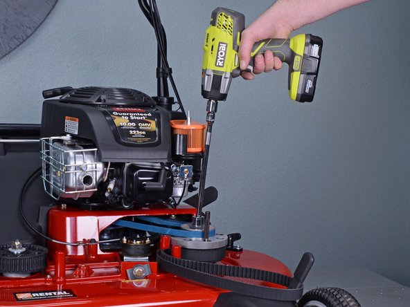

    • Use an impact wrench with a 3/4 inch socket to remove the right sprocket bolt.
    • If necessary, use a punch or screwdriver to lock the sprocket in place during removal, lining up the hole in the sprocket with the hole in the blade guard.
  22. Toro Walk Behind Mowers 21199HD 2018 Right Spindle Replacement: crwdns2935265:022crwdnd2935265:01crwdnd2935265:03crwdne2935265:0 Toro Walk Behind Mowers 21199HD 2018 Right Spindle Replacement: crwdns2935265:022crwdnd2935265:02crwdnd2935265:03crwdne2935265:0 Toro Walk Behind Mowers 21199HD 2018 Right Spindle Replacement: crwdns2935265:022crwdnd2935265:03crwdnd2935265:03crwdne2935265:0

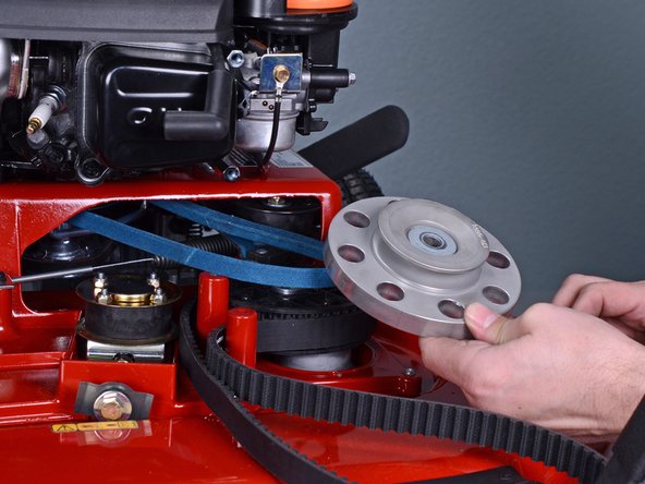

    • Lift up the engine brake.
    • Remove the blue motor belt from the engine brake.

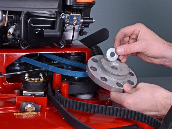

    • Remove the engine brake.
    • Remove the accompanying washer.

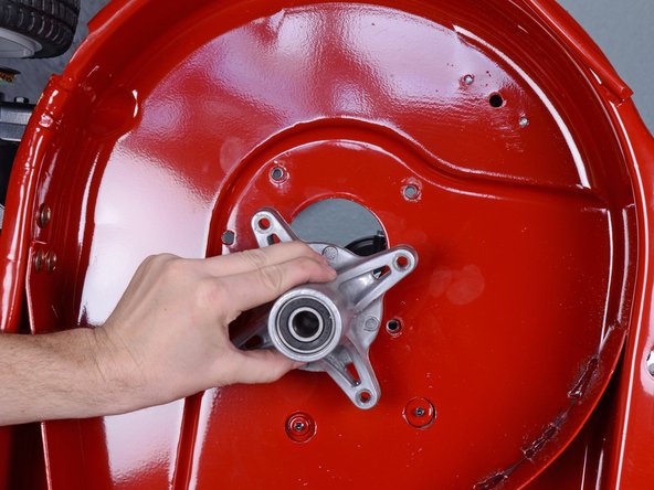

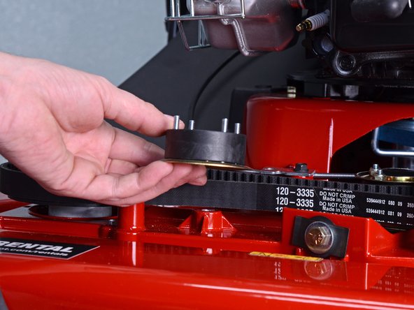

    • Lift the right sprocket and belt up and away from the spindle to remove it.

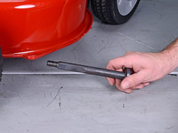

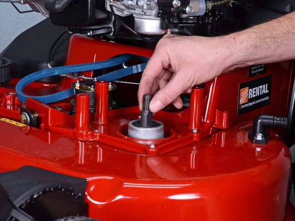

  25. Toro Walk Behind Mowers 21199HD 2018 Right Spindle Replacement, Remove the right spindle shaft: crwdns2935265:025crwdnd2935265:01crwdnd2935265:03crwdne2935265:0 Toro Walk Behind Mowers 21199HD 2018 Right Spindle Replacement, Remove the right spindle shaft: crwdns2935265:025crwdnd2935265:02crwdnd2935265:03crwdne2935265:0 Toro Walk Behind Mowers 21199HD 2018 Right Spindle Replacement, Remove the right spindle shaft: crwdns2935265:025crwdnd2935265:03crwdnd2935265:03crwdne2935265:0
    • Grabbing the spindle shaft from the bottom, lower it down through the spindle.
    • Remove the spindle shaft from underneath the mower.
  26. Toro Walk Behind Mowers 21199HD 2018 Right Spindle Replacement, Remove the spindle bolts: crwdns2935265:026crwdnd2935265:01crwdnd2935265:01crwdne2935265:0
    • Tilt the mower onto its side so the spindle assembly is facing out.
    • This may require two people.
    • Use a 1/2 inch socket to remove the four spindle bolts.
  27. Toro Walk Behind Mowers 21199HD 2018 Right Spindle Replacement, Remove the spindle: crwdns2935265:027crwdnd2935265:01crwdnd2935265:02crwdne2935265:0 Toro Walk Behind Mowers 21199HD 2018 Right Spindle Replacement, Remove the spindle: crwdns2935265:027crwdnd2935265:02crwdnd2935265:02crwdne2935265:0
    • Remove the spindle.
