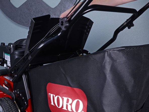

  3. Toro Walk Behind Mowers 21199HD 2018 Right Blade Replacement, Lift up the deflector: crwdns2935265:03crwdnd2935265:01crwdnd2935265:02crwdne2935265:0 Toro Walk Behind Mowers 21199HD 2018 Right Blade Replacement, Lift up the deflector: crwdns2935265:03crwdnd2935265:02crwdnd2935265:02crwdne2935265:0
    • Lift up the plastic deflector.

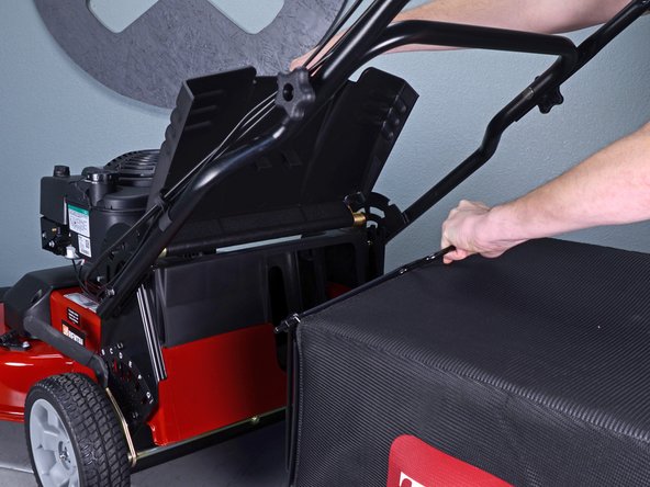

  4. Toro Walk Behind Mowers 21199HD 2018 Right Blade Replacement, Remove the grass bag: crwdns2935265:04crwdnd2935265:01crwdnd2935265:03crwdne2935265:0 Toro Walk Behind Mowers 21199HD 2018 Right Blade Replacement, Remove the grass bag: crwdns2935265:04crwdnd2935265:02crwdnd2935265:03crwdne2935265:0 Toro Walk Behind Mowers 21199HD 2018 Right Blade Replacement, Remove the grass bag: crwdns2935265:04crwdnd2935265:03crwdnd2935265:03crwdne2935265:0
    • While holding the deflector up and out of the way, lift the grass bag handle away from the mower to detach it.
    • Remove the grass bag.

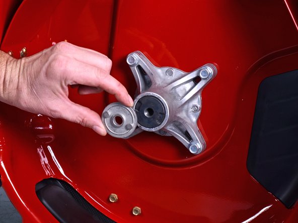

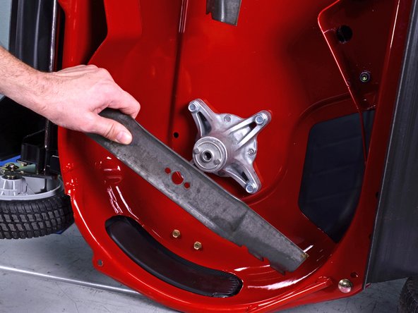

  7. Toro Walk Behind Mowers 21199HD 2018 Right Blade Replacement, Remove the blade: crwdns2935265:07crwdnd2935265:01crwdnd2935265:02crwdne2935265:0 Toro Walk Behind Mowers 21199HD 2018 Right Blade Replacement, Remove the blade: crwdns2935265:07crwdnd2935265:02crwdnd2935265:02crwdne2935265:0
  8. Toro Walk Behind Mowers 21199HD 2018 Right Blade Replacement, Remove the blade key adapter: crwdns2935265:08crwdnd2935265:01crwdnd2935265:02crwdne2935265:0 Toro Walk Behind Mowers 21199HD 2018 Right Blade Replacement, Remove the blade key adapter: crwdns2935265:08crwdnd2935265:02crwdnd2935265:02crwdne2935265:0
    • Remove the right blade key adapter.
Carsten Frauenheim
