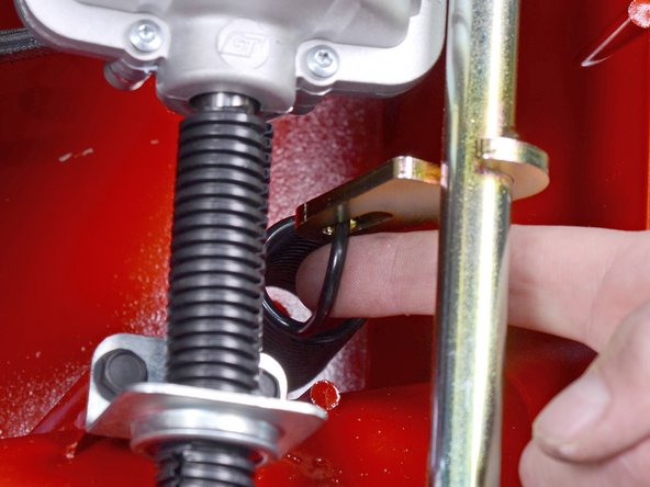

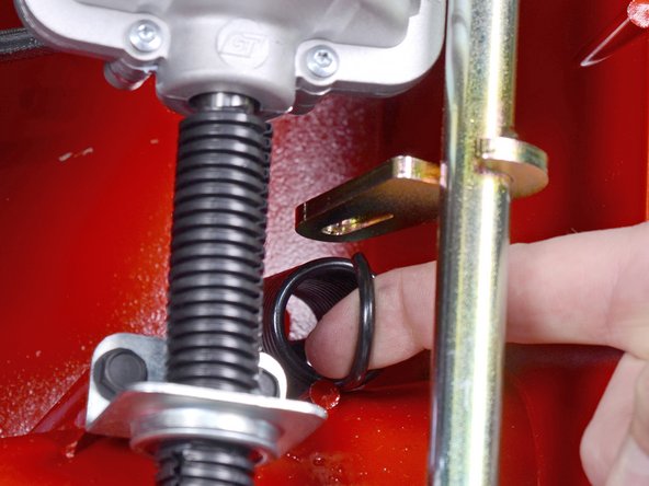

  7. Toro Walk Behind Mowers 21199HD 2018 Rear Axle Replacement, Unhook the axle spring: crwdns2935265:07crwdnd2935265:01crwdnd2935265:03crwdne2935265:0 Toro Walk Behind Mowers 21199HD 2018 Rear Axle Replacement, Unhook the axle spring: crwdns2935265:07crwdnd2935265:02crwdnd2935265:03crwdne2935265:0 Toro Walk Behind Mowers 21199HD 2018 Rear Axle Replacement, Unhook the axle spring: crwdns2935265:07crwdnd2935265:03crwdnd2935265:03crwdne2935265:0
    • Reach underneath the axle, near the transmission, and pull the axle spring out towards the axle and down to unhook it.

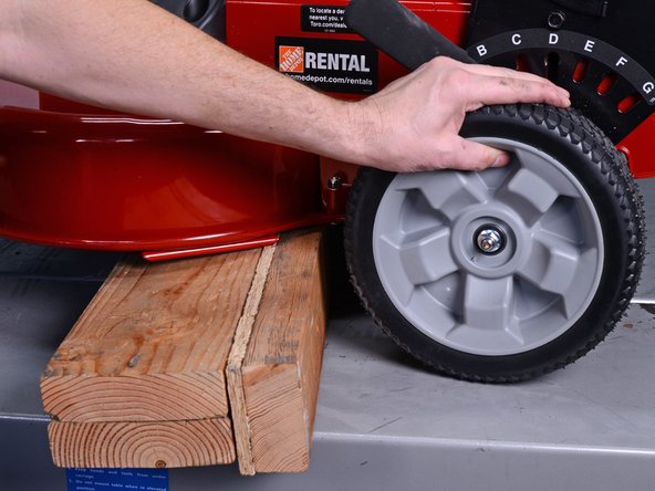

  8. Toro Walk Behind Mowers 21199HD 2018 Rear Axle Replacement, Block up the mower: crwdns2935265:08crwdnd2935265:01crwdnd2935265:02crwdne2935265:0 Toro Walk Behind Mowers 21199HD 2018 Rear Axle Replacement, Block up the mower: crwdns2935265:08crwdnd2935265:02crwdnd2935265:02crwdne2935265:0
    • Place the mower on blocks so each wheel is above the work surface and can rotate freely.

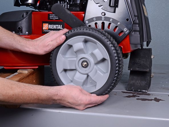

  9. Toro Walk Behind Mowers 21199HD 2018 Rear Axle Replacement, Remove the wheel: crwdns2935265:09crwdnd2935265:01crwdnd2935265:01crwdne2935265:0
    • Use a 9/16 inch socket to remove the wheel nut.

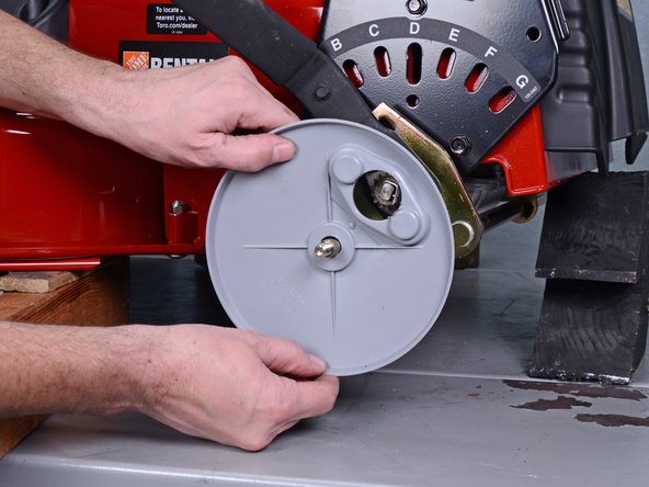

  10. Toro Walk Behind Mowers 21199HD 2018 Rear Axle Replacement: crwdns2935265:010crwdnd2935265:01crwdnd2935265:02crwdne2935265:0 Toro Walk Behind Mowers 21199HD 2018 Rear Axle Replacement: crwdns2935265:010crwdnd2935265:02crwdnd2935265:02crwdne2935265:0
    • Remove the wheel.

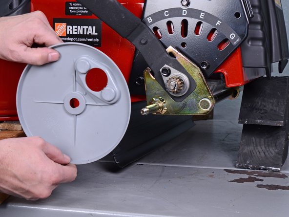

  12. Toro Walk Behind Mowers 21199HD 2018 Rear Axle Replacement: crwdns2935265:012crwdnd2935265:01crwdnd2935265:03crwdne2935265:0 Toro Walk Behind Mowers 21199HD 2018 Rear Axle Replacement: crwdns2935265:012crwdnd2935265:02crwdnd2935265:03crwdne2935265:0 Toro Walk Behind Mowers 21199HD 2018 Rear Axle Replacement: crwdns2935265:012crwdnd2935265:03crwdnd2935265:03crwdne2935265:0

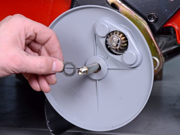

    • Remove the dust cover.

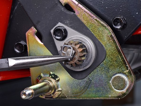

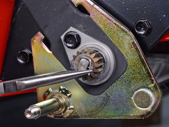

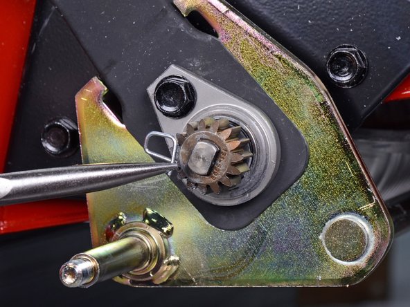

  13. Toro Walk Behind Mowers 21199HD 2018 Rear Axle Replacement: crwdns2935265:013crwdnd2935265:01crwdnd2935265:03crwdne2935265:0 Toro Walk Behind Mowers 21199HD 2018 Rear Axle Replacement: crwdns2935265:013crwdnd2935265:02crwdnd2935265:03crwdne2935265:0 Toro Walk Behind Mowers 21199HD 2018 Rear Axle Replacement: crwdns2935265:013crwdnd2935265:03crwdnd2935265:03crwdne2935265:0
    • Use a pair of needle nose pliers to remove the gear retaining pin.

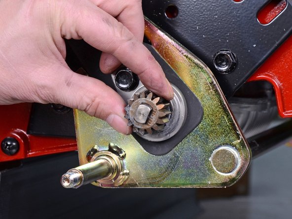

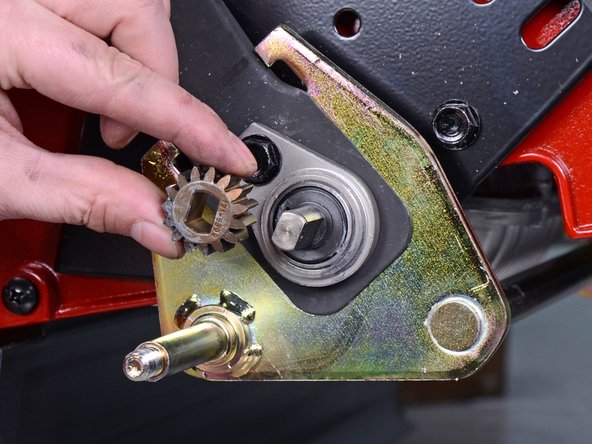

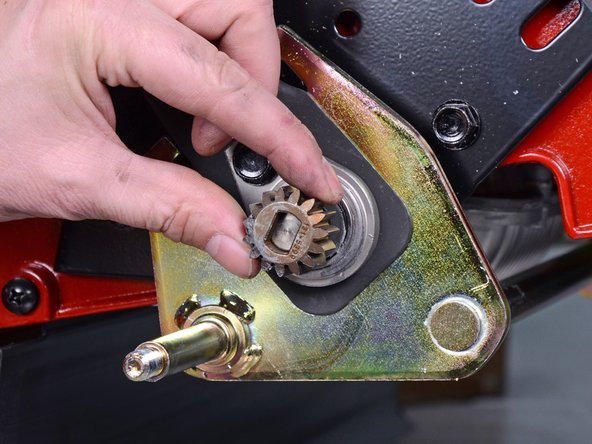

  14. Toro Walk Behind Mowers 21199HD 2018 Rear Axle Replacement: crwdns2935265:014crwdnd2935265:01crwdnd2935265:03crwdne2935265:0 Toro Walk Behind Mowers 21199HD 2018 Rear Axle Replacement: crwdns2935265:014crwdnd2935265:02crwdnd2935265:03crwdne2935265:0 Toro Walk Behind Mowers 21199HD 2018 Rear Axle Replacement: crwdns2935265:014crwdnd2935265:03crwdnd2935265:03crwdne2935265:0
    • Remove the drive gear.

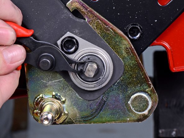

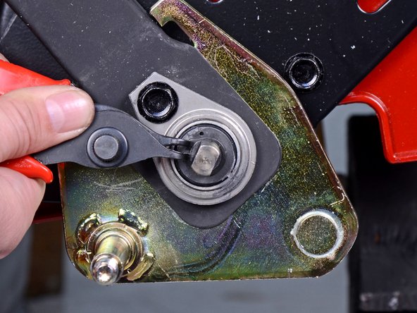

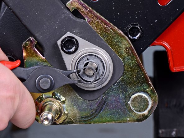

  15. Toro Walk Behind Mowers 21199HD 2018 Rear Axle Replacement: crwdns2935265:015crwdnd2935265:01crwdnd2935265:03crwdne2935265:0 Toro Walk Behind Mowers 21199HD 2018 Rear Axle Replacement: crwdns2935265:015crwdnd2935265:02crwdnd2935265:03crwdne2935265:0 Toro Walk Behind Mowers 21199HD 2018 Rear Axle Replacement: crwdns2935265:015crwdnd2935265:03crwdnd2935265:03crwdne2935265:0
    • Use a pair of snap ring pliers to remove the snap ring from the driveline.

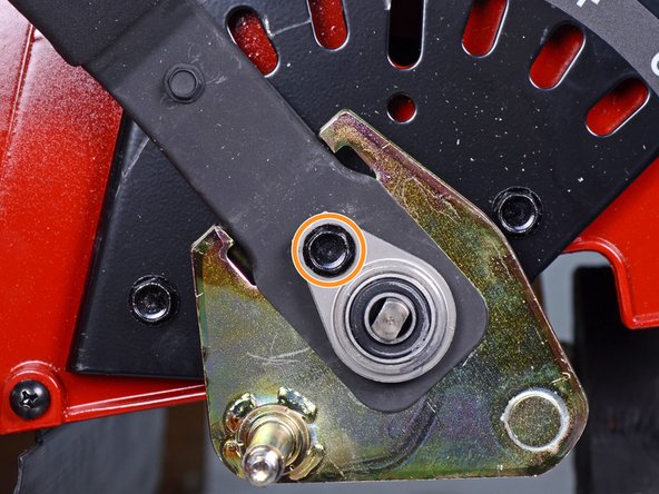

    • Use a 1/2 inch socket to remove the driveline bearing retaining bolt.

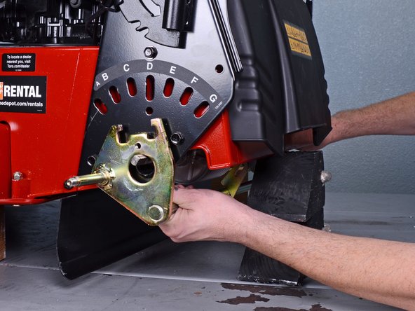

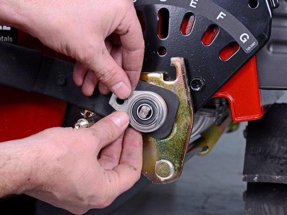

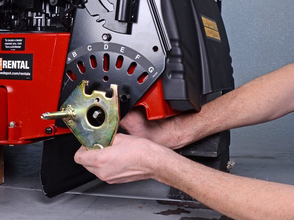

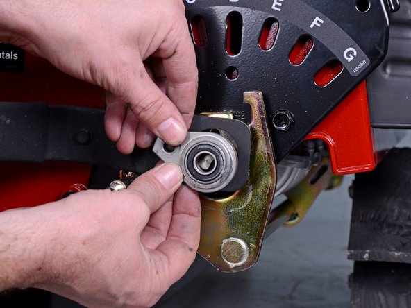

  18. Toro Walk Behind Mowers 21199HD 2018 Rear Axle Replacement: crwdns2935265:018crwdnd2935265:01crwdnd2935265:03crwdne2935265:0 Toro Walk Behind Mowers 21199HD 2018 Rear Axle Replacement: crwdns2935265:018crwdnd2935265:02crwdnd2935265:03crwdne2935265:0 Toro Walk Behind Mowers 21199HD 2018 Rear Axle Replacement: crwdns2935265:018crwdnd2935265:03crwdnd2935265:03crwdne2935265:0
    • Firmly pull the driveline bearing away from the mower.
    • This bearing is holding the driveline in place, so some components may shift around during removal.
    • This may require some force.

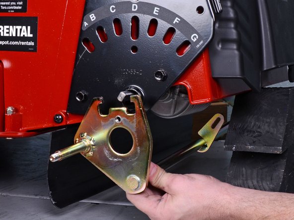

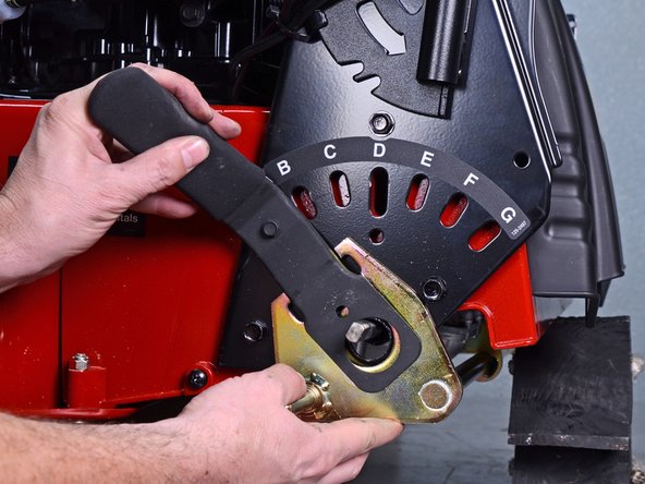

  19. Toro Walk Behind Mowers 21199HD 2018 Rear Axle Replacement, Remove the height adjustment lever: crwdns2935265:019crwdnd2935265:01crwdnd2935265:02crwdne2935265:0 Toro Walk Behind Mowers 21199HD 2018 Rear Axle Replacement, Remove the height adjustment lever: crwdns2935265:019crwdnd2935265:02crwdnd2935265:02crwdne2935265:0
    • Remove the height adjustment lever from the left side of the mower.

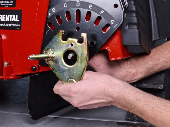

  20. Toro Walk Behind Mowers 21199HD 2018 Rear Axle Replacement, Remove the axle: crwdns2935265:020crwdnd2935265:01crwdnd2935265:03crwdne2935265:0 Toro Walk Behind Mowers 21199HD 2018 Rear Axle Replacement, Remove the axle: crwdns2935265:020crwdnd2935265:02crwdnd2935265:03crwdne2935265:0 Toro Walk Behind Mowers 21199HD 2018 Rear Axle Replacement, Remove the axle: crwdns2935265:020crwdnd2935265:03crwdnd2935265:03crwdne2935265:0
    • Holding the left end of the axle with your left hand and the right end of the driveline with your right hand, firmly pull them in opposite directions—the axle to the left, and the driveline to the right.
    • While maintaining these opposing forces, squeeze both axles together.

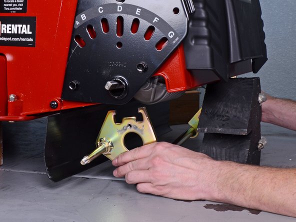

  21. Toro Walk Behind Mowers 21199HD 2018 Rear Axle Replacement: crwdns2935265:021crwdnd2935265:01crwdnd2935265:02crwdne2935265:0 Toro Walk Behind Mowers 21199HD 2018 Rear Axle Replacement: crwdns2935265:021crwdnd2935265:02crwdnd2935265:02crwdne2935265:0
    • With the axle being pulled left and driveline being pulled right, force the left end of the axle out and down, around the end of the driveline.
    • If done correctly, there will be enough of a gap for the axle to clear the end of the driveline and drop down towards the work surface.
  22. Toro Walk Behind Mowers 21199HD 2018 Rear Axle Replacement: crwdns2935265:022crwdnd2935265:01crwdnd2935265:02crwdne2935265:0 Toro Walk Behind Mowers 21199HD 2018 Rear Axle Replacement: crwdns2935265:022crwdnd2935265:02crwdnd2935265:02crwdne2935265:0
    • Remove the axle.

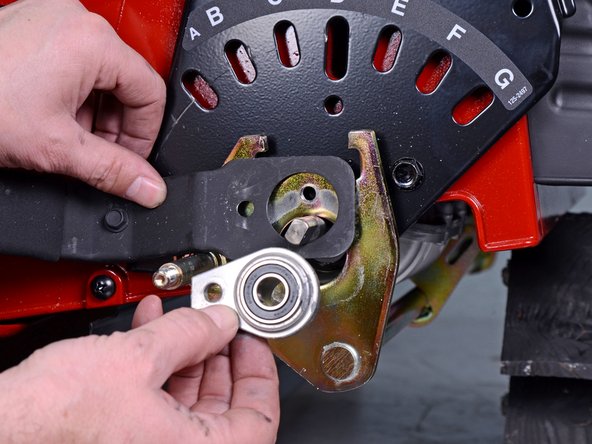

  24. Toro Walk Behind Mowers 21199HD 2018 Rear Axle Replacement, Install the height adjustment lever: crwdns2935265:024crwdnd2935265:01crwdnd2935265:02crwdne2935265:0 Toro Walk Behind Mowers 21199HD 2018 Rear Axle Replacement, Install the height adjustment lever: crwdns2935265:024crwdnd2935265:02crwdnd2935265:02crwdne2935265:0
    • Place the height adjustment lever into position.
  25. Toro Walk Behind Mowers 21199HD 2018 Rear Axle Replacement, Reinstall left and right side axle components: crwdns2935265:025crwdnd2935265:01crwdnd2935265:03crwdne2935265:0 Toro Walk Behind Mowers 21199HD 2018 Rear Axle Replacement, Reinstall left and right side axle components: crwdns2935265:025crwdnd2935265:02crwdnd2935265:03crwdne2935265:0 Toro Walk Behind Mowers 21199HD 2018 Rear Axle Replacement, Reinstall left and right side axle components: crwdns2935265:025crwdnd2935265:03crwdnd2935265:03crwdne2935265:0
    • Push the driveline bearing onto the protruding end of the driveline.
    • Align the height adjustment lever and driveline bearing bolt with the hole on the axle.
    • Align the components such that the height adjustment lever falls into the "A" position.
    • Using a 1/2 inch socket, secure both in place with the driveline bearing bolt, but don't tighten it all the way yet.
    • Install the right driveline bearing onto the right side of the mower, securing it in place with the 1/2 inch driveline bearing bolt.
    • Now, securely tighten both left and right side driveline bearing bolts
  26. Toro Walk Behind Mowers 21199HD 2018 Rear Axle Replacement, Install the left side snap ring washer: crwdns2935265:026crwdnd2935265:01crwdnd2935265:01crwdne2935265:0
    • Install the snap ring washer on the driveline.
  27. Toro Walk Behind Mowers 21199HD 2018 Rear Axle Replacement, Install the snap ring: crwdns2935265:027crwdnd2935265:01crwdnd2935265:03crwdne2935265:0 Toro Walk Behind Mowers 21199HD 2018 Rear Axle Replacement, Install the snap ring: crwdns2935265:027crwdnd2935265:02crwdnd2935265:03crwdne2935265:0 Toro Walk Behind Mowers 21199HD 2018 Rear Axle Replacement, Install the snap ring: crwdns2935265:027crwdnd2935265:03crwdnd2935265:03crwdne2935265:0
    • With another person pushing on the driveline from the other side, use snap ring pliers to install the snap ring into the groove on the driveline.
    • This can be difficult, and can require a fair amount of force.
    • The snap ring groove on the left side of the driveline will not be visible until the driveline is pushed far enough left.
    • You may need to push back against the axle during this process so the height adjustment lever and driveline bearing stay against the frame.

  30. Toro Walk Behind Mowers 21199HD 2018 Rear Axle Replacement, Install the dust covers: crwdns2935265:030crwdnd2935265:01crwdnd2935265:02crwdne2935265:0 Toro Walk Behind Mowers 21199HD 2018 Rear Axle Replacement, Install the dust covers: crwdns2935265:030crwdnd2935265:02crwdnd2935265:02crwdne2935265:0
    • Install both dust covers, one on either side of the axle.

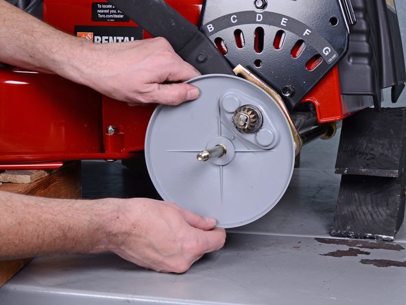

  31. Toro Walk Behind Mowers 21199HD 2018 Rear Axle Replacement, Install the wheels: crwdns2935265:031crwdnd2935265:01crwdnd2935265:02crwdne2935265:0 Toro Walk Behind Mowers 21199HD 2018 Rear Axle Replacement, Install the wheels: crwdns2935265:031crwdnd2935265:02crwdnd2935265:02crwdne2935265:0
    • Place both wheels back onto the axle, aligning the drive gear teeth with the gears inside the wheels.
  32. Toro Walk Behind Mowers 21199HD 2018 Rear Axle Replacement: crwdns2935265:032crwdnd2935265:01crwdnd2935265:01crwdne2935265:0
    • Use a 9/16 inch socket to reinstall both wheel nuts, securing the wheels to the axle.

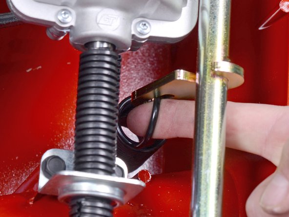

  34. Toro Walk Behind Mowers 21199HD 2018 Rear Axle Replacement, Hook the spring onto the axle: crwdns2935265:034crwdnd2935265:01crwdnd2935265:03crwdne2935265:0 Toro Walk Behind Mowers 21199HD 2018 Rear Axle Replacement, Hook the spring onto the axle: crwdns2935265:034crwdnd2935265:02crwdnd2935265:03crwdne2935265:0 Toro Walk Behind Mowers 21199HD 2018 Rear Axle Replacement, Hook the spring onto the axle: crwdns2935265:034crwdnd2935265:03crwdnd2935265:03crwdne2935265:0
    • Hook the height adjustment spring back onto the axle.
    • This will be difficult if the height adjustment lever isn't in the "A" position.
