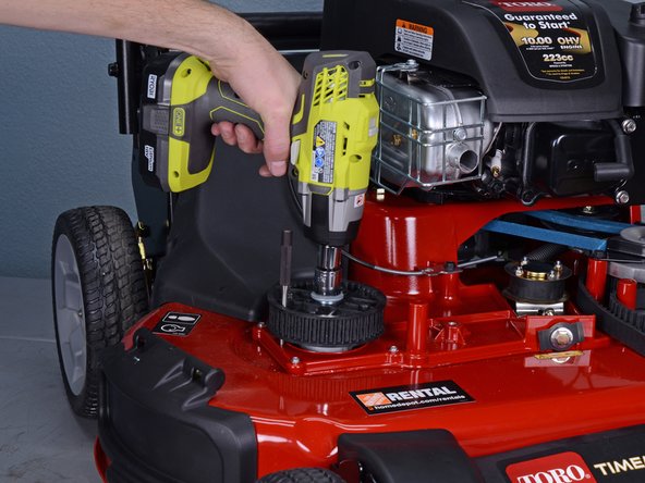

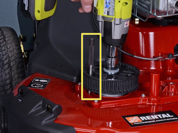

  15. Toro Walk Behind Mowers 21199HD 2018 Left Spindle Replacement, Remove the sprocket bolt: crwdns2935265:015crwdnd2935265:01crwdnd2935265:03crwdne2935265:0 Toro Walk Behind Mowers 21199HD 2018 Left Spindle Replacement, Remove the sprocket bolt: crwdns2935265:015crwdnd2935265:02crwdnd2935265:03crwdne2935265:0 Toro Walk Behind Mowers 21199HD 2018 Left Spindle Replacement, Remove the sprocket bolt: crwdns2935265:015crwdnd2935265:03crwdnd2935265:03crwdne2935265:0
    • Use an impact wrench with a 3/4 inch socket to remove the left sprocket bolt.
    • If necessary, use a punch or screwdriver to lock the sprocket in place during removal, lining up the hole in the sprocket with the hole in the blade guard.

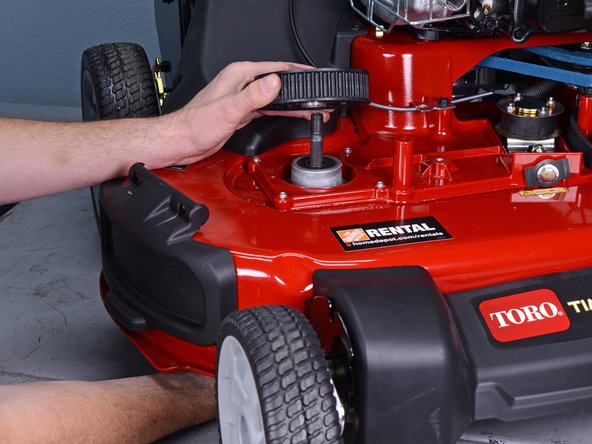

  16. Toro Walk Behind Mowers 21199HD 2018 Left Spindle Replacement, Remove the sprocket: crwdns2935265:016crwdnd2935265:01crwdnd2935265:02crwdne2935265:0 Toro Walk Behind Mowers 21199HD 2018 Left Spindle Replacement, Remove the sprocket: crwdns2935265:016crwdnd2935265:02crwdnd2935265:02crwdne2935265:0
    • While holding the spindle shaft from underneath, lift the sprocket up to remove it.

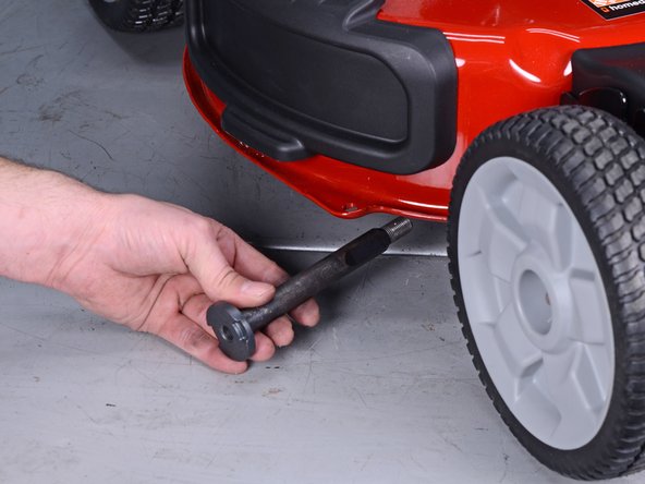

  17. Toro Walk Behind Mowers 21199HD 2018 Left Spindle Replacement, Remove the left spindle shaft: crwdns2935265:017crwdnd2935265:01crwdnd2935265:03crwdne2935265:0 Toro Walk Behind Mowers 21199HD 2018 Left Spindle Replacement, Remove the left spindle shaft: crwdns2935265:017crwdnd2935265:02crwdnd2935265:03crwdne2935265:0 Toro Walk Behind Mowers 21199HD 2018 Left Spindle Replacement, Remove the left spindle shaft: crwdns2935265:017crwdnd2935265:03crwdnd2935265:03crwdne2935265:0
    • Grabbing the spindle shaft from the bottom, lower it down through the spindle.
    • Remove the spindle shaft from underneath the mower.
