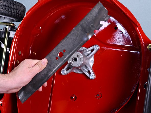

  6. Toro Walk Behind Mowers 21199HD 2018 Left Blade Replacement, Remove the blade bolt: crwdns2935265:06crwdnd2935265:01crwdnd2935265:02crwdne2935265:0 Toro Walk Behind Mowers 21199HD 2018 Left Blade Replacement, Remove the blade bolt: crwdns2935265:06crwdnd2935265:02crwdnd2935265:02crwdne2935265:0
    • Use an impact driver with a 5/8-inch socket to remove the left blade bolt.
    • If necessary, brace the blade with a screwdriver or extension by placing it in the hole in the metal blade guard.
  7. Toro Walk Behind Mowers 21199HD 2018 Left Blade Replacement, Remove the blade: crwdns2935265:07crwdnd2935265:01crwdnd2935265:02crwdne2935265:0 Toro Walk Behind Mowers 21199HD 2018 Left Blade Replacement, Remove the blade: crwdns2935265:07crwdnd2935265:02crwdnd2935265:02crwdne2935265:0

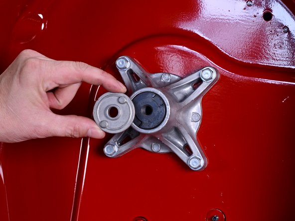

  8. Toro Walk Behind Mowers 21199HD 2018 Left Blade Replacement, Remove the blade key adapter: crwdns2935265:08crwdnd2935265:01crwdnd2935265:02crwdne2935265:0 Toro Walk Behind Mowers 21199HD 2018 Left Blade Replacement, Remove the blade key adapter: crwdns2935265:08crwdnd2935265:02crwdnd2935265:02crwdne2935265:0
    • Remove the left blade key adapter.
