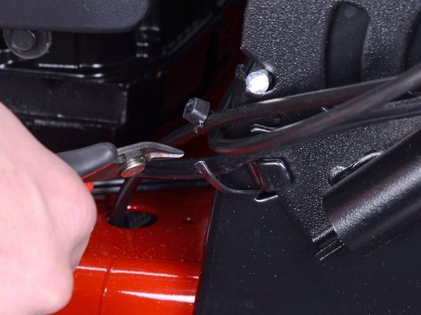

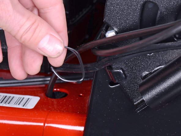

  5. Toro Walk Behind Mowers 21199HD 2018 Brake Cable Replacement, Cut the zip tie: crwdns2935265:05crwdnd2935265:01crwdnd2935265:03crwdne2935265:0 Toro Walk Behind Mowers 21199HD 2018 Brake Cable Replacement, Cut the zip tie: crwdns2935265:05crwdnd2935265:02crwdnd2935265:03crwdne2935265:0 Toro Walk Behind Mowers 21199HD 2018 Brake Cable Replacement, Cut the zip tie: crwdns2935265:05crwdnd2935265:03crwdnd2935265:03crwdne2935265:0
    • Cut and remove the zip tie holding the cables together near the base of the handle.
    • During reassembly, replace this zip tie.

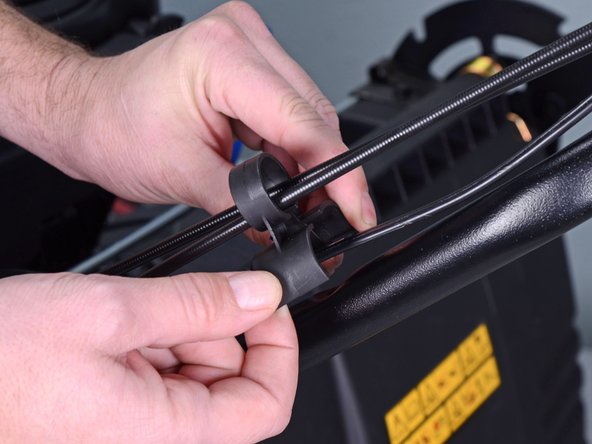

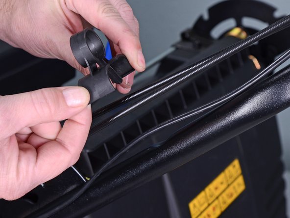

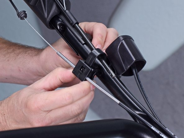

  6. Toro Walk Behind Mowers 21199HD 2018 Brake Cable Replacement, Remove the cable guides: crwdns2935265:06crwdnd2935265:01crwdnd2935265:02crwdne2935265:0 Toro Walk Behind Mowers 21199HD 2018 Brake Cable Replacement, Remove the cable guides: crwdns2935265:06crwdnd2935265:02crwdnd2935265:02crwdne2935265:0
    • Use your fingers and press up from the bottom to remove the plastic cable guide from the handle.
  7. Toro Walk Behind Mowers 21199HD 2018 Brake Cable Replacement: crwdns2935265:07crwdnd2935265:01crwdnd2935265:03crwdne2935265:0 Toro Walk Behind Mowers 21199HD 2018 Brake Cable Replacement: crwdns2935265:07crwdnd2935265:02crwdnd2935265:03crwdne2935265:0 Toro Walk Behind Mowers 21199HD 2018 Brake Cable Replacement: crwdns2935265:07crwdnd2935265:03crwdnd2935265:03crwdne2935265:0

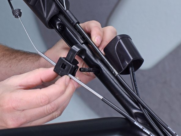

    • Spread the cable guide apart and remove it from the cables.

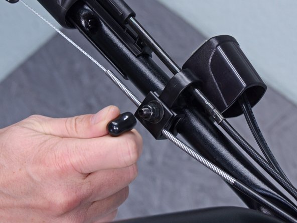

    • Remove the black silicone cap covering the nut on the kill switch and upper cable guide assembly.
  9. Toro Walk Behind Mowers 21199HD 2018 Brake Cable Replacement: crwdns2935265:09crwdnd2935265:01crwdnd2935265:01crwdne2935265:0
    • Use a 7/16 inch socket or wrench to remove the nut securing the kill switch and upper cable guide assembly.

    • Unclip and remove the upper cable guide from the handle.
    • Unroute the cables from the cable guide.

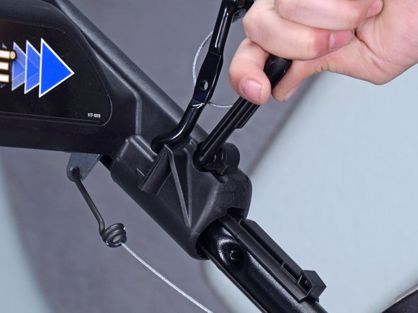

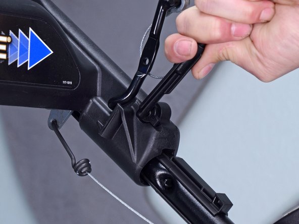

  11. Toro Walk Behind Mowers 21199HD 2018 Brake Cable Replacement, Detach the retainer arm: crwdns2935265:011crwdnd2935265:01crwdnd2935265:03crwdne2935265:0 Toro Walk Behind Mowers 21199HD 2018 Brake Cable Replacement, Detach the retainer arm: crwdns2935265:011crwdnd2935265:02crwdnd2935265:03crwdne2935265:0 Toro Walk Behind Mowers 21199HD 2018 Brake Cable Replacement, Detach the retainer arm: crwdns2935265:011crwdnd2935265:03crwdnd2935265:03crwdne2935265:0
    • Rotate the cable retainer arm 90˚ upwards, perpendicular to the handle, to unlock it.
    • Pull the arm away from the handle to remove it.

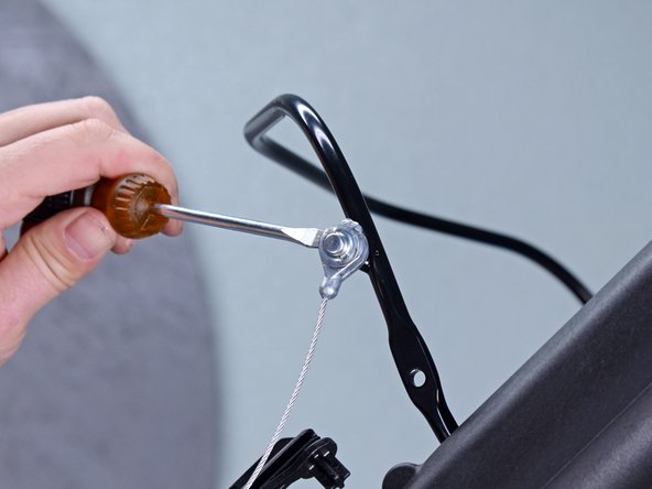

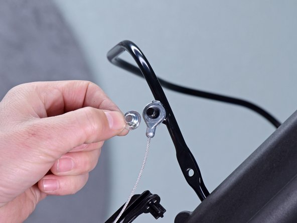

  12. Toro Walk Behind Mowers 21199HD 2018 Brake Cable Replacement, Remove the cable from the brake handle: crwdns2935265:012crwdnd2935265:01crwdnd2935265:03crwdne2935265:0 Toro Walk Behind Mowers 21199HD 2018 Brake Cable Replacement, Remove the cable from the brake handle: crwdns2935265:012crwdnd2935265:02crwdnd2935265:03crwdne2935265:0 Toro Walk Behind Mowers 21199HD 2018 Brake Cable Replacement, Remove the cable from the brake handle: crwdns2935265:012crwdnd2935265:03crwdnd2935265:03crwdne2935265:0

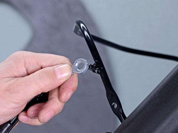

    • Use a flathead screwdriver to pry off the single-use cap locking the brake cable to the brake handle.
    • During reassembly, replace this single-use cap.
  13. Toro Walk Behind Mowers 21199HD 2018 Brake Cable Replacement: crwdns2935265:013crwdnd2935265:01crwdnd2935265:02crwdne2935265:0 Toro Walk Behind Mowers 21199HD 2018 Brake Cable Replacement: crwdns2935265:013crwdnd2935265:02crwdnd2935265:02crwdne2935265:0
    • Remove the brake cable from the brake handle.

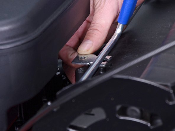

  14. Toro Walk Behind Mowers 21199HD 2018 Brake Cable Replacement, Remove the guide plates: crwdns2935265:014crwdnd2935265:01crwdnd2935265:01crwdne2935265:0
    • Use a 3/8 inch socket to remove the cable guide plate screw.
  15. Toro Walk Behind Mowers 21199HD 2018 Brake Cable Replacement: crwdns2935265:015crwdnd2935265:01crwdnd2935265:02crwdne2935265:0 Toro Walk Behind Mowers 21199HD 2018 Brake Cable Replacement: crwdns2935265:015crwdnd2935265:02crwdnd2935265:02crwdne2935265:0
    • Remove the cable guide plate.

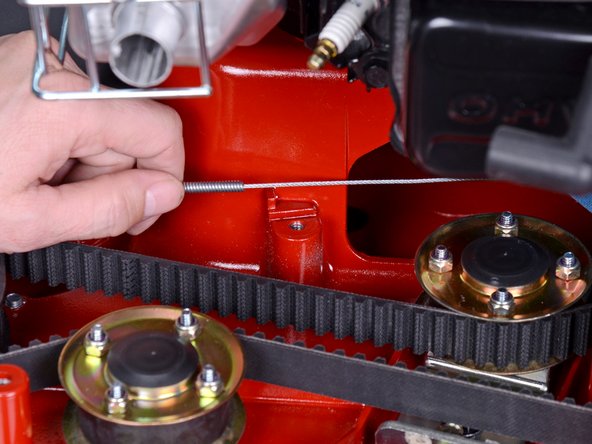

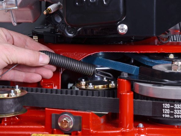

  18. Toro Walk Behind Mowers 21199HD 2018 Brake Cable Replacement, Find the end of the brake cable: crwdns2935265:018crwdnd2935265:01crwdnd2935265:03crwdne2935265:0 Toro Walk Behind Mowers 21199HD 2018 Brake Cable Replacement, Find the end of the brake cable: crwdns2935265:018crwdnd2935265:02crwdnd2935265:03crwdne2935265:0 Toro Walk Behind Mowers 21199HD 2018 Brake Cable Replacement, Find the end of the brake cable: crwdns2935265:018crwdnd2935265:03crwdnd2935265:03crwdne2935265:0

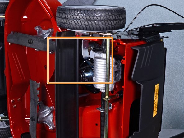

    • Before tilting the mower, drain the gas tank.
    • Tilt the mower onto its side, propping the handle up with a block of wood.
    • Locate the end of the brake cable underneath the mower, in front of the driveline, and above the blade guard.
    • The end of the brake cable is attached to a spring, and they come out as one unit.

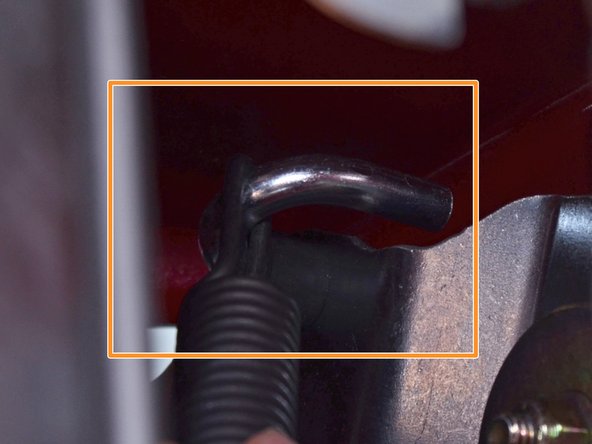

    • The spring is hooked to a shiny U-shaped post.

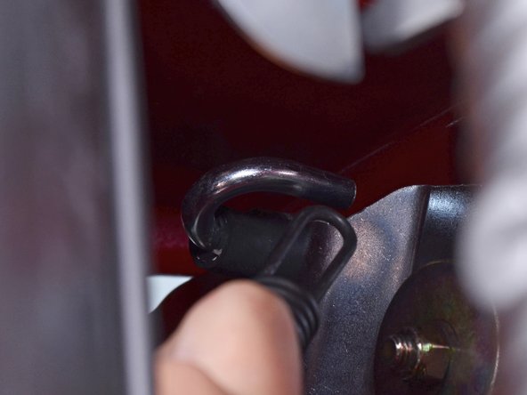

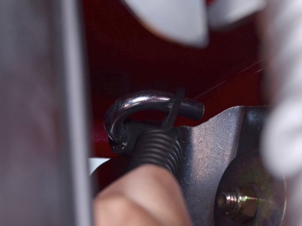

  19. Toro Walk Behind Mowers 21199HD 2018 Brake Cable Replacement, Remove the brake cable: crwdns2935265:019crwdnd2935265:01crwdnd2935265:03crwdne2935265:0 Toro Walk Behind Mowers 21199HD 2018 Brake Cable Replacement, Remove the brake cable: crwdns2935265:019crwdnd2935265:02crwdnd2935265:03crwdne2935265:0 Toro Walk Behind Mowers 21199HD 2018 Brake Cable Replacement, Remove the brake cable: crwdns2935265:019crwdnd2935265:03crwdnd2935265:03crwdne2935265:0
    • Reach into the underside of the mower and grab the spring at the end of the brake cable.
    • Slide the spring towards the open end of the U-shaped post.
    • This can be a difficult area to see and reach. Use a flashlight if need be.

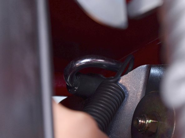

  20. Toro Walk Behind Mowers 21199HD 2018 Brake Cable Replacement: crwdns2935265:020crwdnd2935265:01crwdnd2935265:03crwdne2935265:0 Toro Walk Behind Mowers 21199HD 2018 Brake Cable Replacement: crwdns2935265:020crwdnd2935265:02crwdnd2935265:03crwdne2935265:0 Toro Walk Behind Mowers 21199HD 2018 Brake Cable Replacement: crwdns2935265:020crwdnd2935265:03crwdnd2935265:03crwdne2935265:0
    • Remove the spring from the U-shaped post.
    • Once unhooked, you can flip the mower back onto its wheels.
