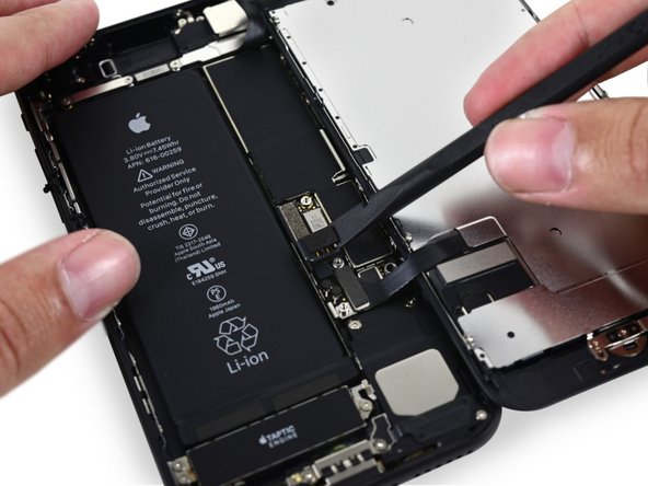

    2. Tools Best Practices, Plastic Opening Tool: crwdns2935265:02crwdnd2935265:01crwdnd2935265:02crwdne2935265:0 Tools Best Practices, Plastic Opening Tool: crwdns2935265:02crwdnd2935265:02crwdnd2935265:02crwdne2935265:0
      • The plastic opening tool comes in a few different styles, and is your go-to tool for removing screens and separating cases. It has a very thin non-destructive edge that gets in between small cracks easily.
      • Use the plastic opening tool to:
      • Lift zero insertion force (ZIF) tabs and disconnect cable connectors.
      • Pry open tightly sealed device cases.
      • Remove digitizers and glass screens.
      • Lift, cut, or remove tape, adhesive, and/or thermal paste.

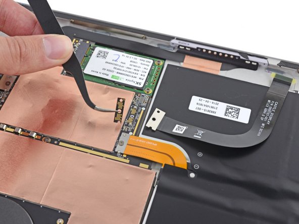

    4. Tools Best Practices, Tweezers: crwdns2935265:04crwdnd2935265:01crwdnd2935265:02crwdne2935265:0 Tools Best Practices, Tweezers: crwdns2935265:04crwdnd2935265:02crwdnd2935265:02crwdne2935265:0
      • With blunt or curved tip options, the ESD safe tweezers are a tricksy little tool. They're especially helpful if you have thick, hobbitsy, fingers.
      • Use tweezers to:
      • Remove loose screws or small components that are difficult to access.
      • Gently remove ribbon cables.
      • Peel heated panels after applying heat.
      • The angled and fine-tip tweezers have very sharp tips. Exercise caution around delicate ribbon cables and your fingers.

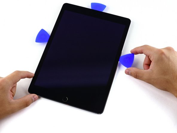

    5. Tools Best Practices, Opening Picks: crwdns2935265:05crwdnd2935265:01crwdnd2935265:02crwdne2935265:0 Tools Best Practices, Opening Picks: crwdns2935265:05crwdnd2935265:02crwdnd2935265:02crwdne2935265:0
      • Opening picks are an industry favorite for maintaining a separation between screens and cases, or for breaking up long sections of adhesive. Feel free to explore your options.
      • Use opening picks to:
      • Cut adhesive strips that secure screens.
      • Use as a placeholder to prevent large screens from receding back into the frame.
      • Scrape or remove adhesive or tape.
      • Apply or remove thermal paste.
