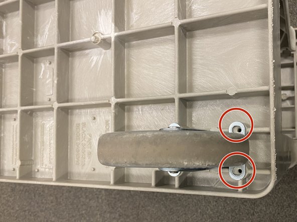

    • Flip the cart over so that the wheels are facing up.
  2. Tool Cart Wheel Replacement: crwdns2935265:02crwdnd2935265:01crwdnd2935265:02crwdne2935265:0 Tool Cart Wheel Replacement: crwdns2935265:02crwdnd2935265:02crwdnd2935265:02crwdne2935265:0
    • Use the Phillips #2 screwdriver to remove all the screws from the metal plate.
  3. Tool Cart Wheel Replacement: crwdns2935265:03crwdnd2935265:01crwdnd2935265:02crwdne2935265:0 Tool Cart Wheel Replacement: crwdns2935265:03crwdnd2935265:02crwdnd2935265:02crwdne2935265:0
    • Remove the old wheel.
    • Place the new wheel with the metal plate directly on top of the cart so that the holes on the metal plate are aligned with the holes on the cart.
  4. Tool Cart Wheel Replacement: crwdns2935265:04crwdnd2935265:01crwdnd2935265:01crwdne2935265:0
    • With the Phillips #2 screwdriver, secure the screws back in diagonally.
  5. Tool Cart Wheel Replacement: crwdns2935265:05crwdnd2935265:01crwdnd2935265:01crwdne2935265:0
    • Insert and secure the other two screws.
