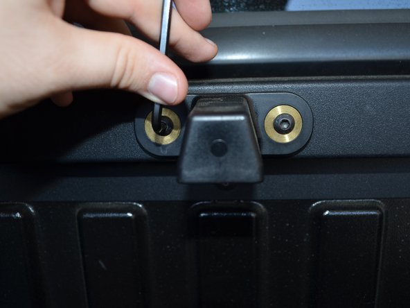

    • Locate the two screws on the retaining latch.
    • Use an Allen Wrench to loosen the screws.
    • The screws are tight and may require significant force.

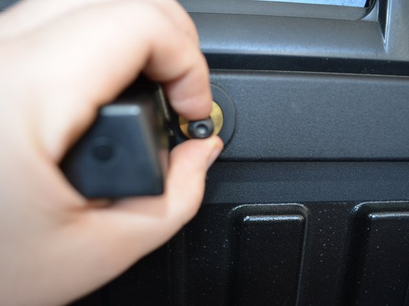

    • Continue loosening the screws until they are both loose enough to remove by hand.

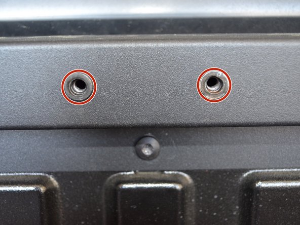

    • Grab both screws and pull them straight out.

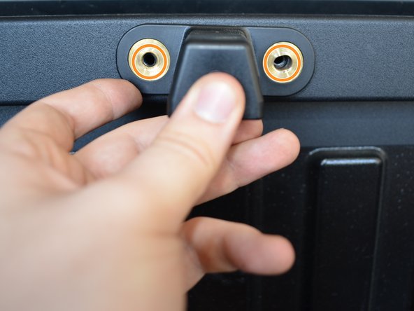

    • Line up the holes on the replacement latch, then insert the new screws.
  4. Tonneau Trifold Bed Cover Retention Pin Replacement: crwdns2935265:04crwdnd2935265:01crwdnd2935265:03crwdne2935265:0 Tonneau Trifold Bed Cover Retention Pin Replacement: crwdns2935265:04crwdnd2935265:02crwdnd2935265:03crwdne2935265:0 Tonneau Trifold Bed Cover Retention Pin Replacement: crwdns2935265:04crwdnd2935265:03crwdnd2935265:03crwdne2935265:0
    • Hand tighten both of the bolts onto the new latch.

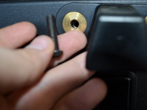

    • Tighten both screws evenly until the latch is held firmly in place.
    • Do not over tighten - you could break the Allen Wrench or strip the screws!
