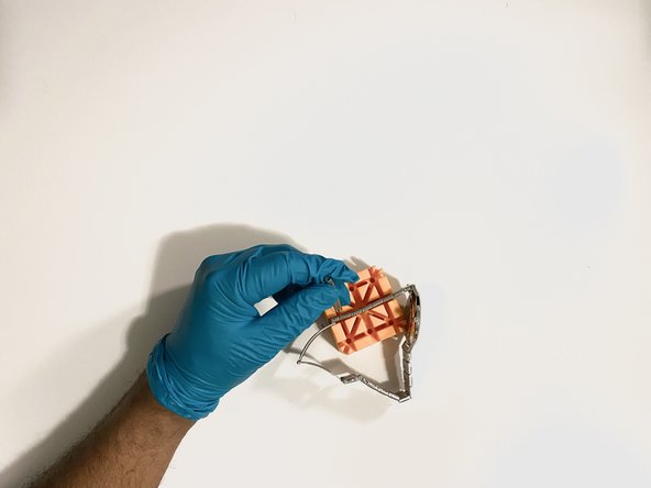

    • Place the watch on your wrist and approximate the number of links to be removed.
  2. Tommy Hilfiger Quartz Watch Band Link Replacement: crwdns2935265:02crwdnd2935265:01crwdnd2935265:01crwdne2935265:0

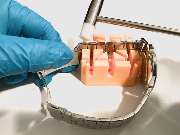

    • Lay and secure the wristband on the watchband holder.
  4. Tommy Hilfiger Quartz Watch Band Link Replacement: crwdns2935265:04crwdnd2935265:01crwdnd2935265:03crwdne2935265:0 Tommy Hilfiger Quartz Watch Band Link Replacement: crwdns2935265:04crwdnd2935265:02crwdnd2935265:03crwdne2935265:0 Tommy Hilfiger Quartz Watch Band Link Replacement: crwdns2935265:04crwdnd2935265:03crwdnd2935265:03crwdne2935265:0
    • Align the tip of the pin pusher on the pin.
    • Begin tapping the hammer with force to push the link pin out.
