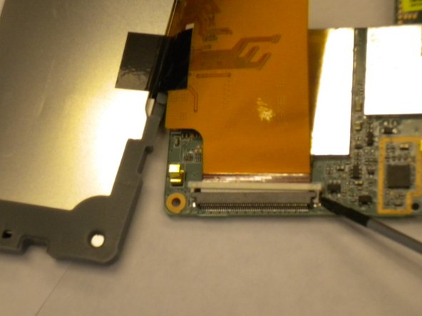

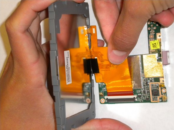

  7. TomTom XL Motherboard Replacement, Screen: crwdns2935265:07crwdnd2935265:01crwdnd2935265:03crwdne2935265:0 TomTom XL Motherboard Replacement, Screen: crwdns2935265:07crwdnd2935265:02crwdnd2935265:03crwdne2935265:0 TomTom XL Motherboard Replacement, Screen: crwdns2935265:07crwdnd2935265:03crwdnd2935265:03crwdne2935265:0
    • Using your thumbs or the flat end of a spudger, push back the white tabs on the display cable ZIF connector.
    • Gently pull the orange display cable out of the ZIF connector.
    • The display cable should slide out easily, but it may still have some adhesive on the underside. If you feel resistance, gently lift up on the ribbon cable while pulling it from the socket.
