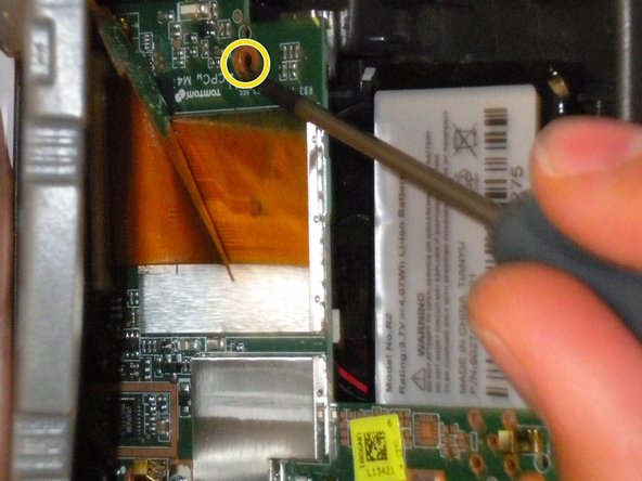

    • Remove the three Phillips #00 screws connecting the motherboard to the plastic housing:
    • Two Phillips #00 screws are located at the bottom of the first picture.
    • The third screw is hidden under the orange ribbon cable, near the screen.
    • You may have to carefully lift the screen in order to reach this screw.

Note: There are several variants of this. Some of them have 2 screws on the bottom under the stickers. You'll need to remove those first.

nathanrenniewaldock is right... I cracked my screen before finding the hidden screws on the bottom. what a silly company to use the same name for different models!
