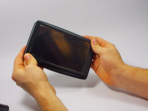

    • Locate the round suction cup on the back of the device.
    • Twist the suction cup clockwise or counterclockwise while pulling back away from the device closer to your body until removed.
    • When reassembling twist the suction cup but, push in as oppose to pulling out.
  2. TomTom VIA 1605TM Front Screen Replacement: crwdns2935265:02crwdnd2935265:01crwdnd2935265:01crwdne2935265:0
    • Location of screw is where the suction cup was.
    • Insert 8mm Hex #T6 screw driver into screw.
    • Unscrew in counter clockwise direction.
    • When reassembling screw in the clockwise direction.

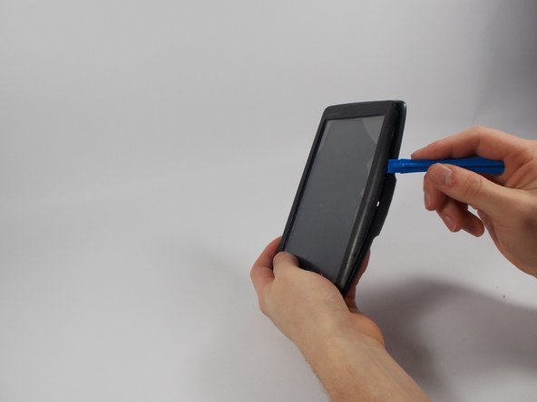

  3. TomTom VIA 1605TM Front Screen Replacement: crwdns2935265:03crwdnd2935265:01crwdnd2935265:02crwdne2935265:0 TomTom VIA 1605TM Front Screen Replacement: crwdns2935265:03crwdnd2935265:02crwdnd2935265:02crwdne2935265:0
    • Pry along the edges with the plastic opening tool to separate the back and front panel.
    • Try not to tear the screen open as you may break the part. Go about this gently but with enough force to remove the screen.

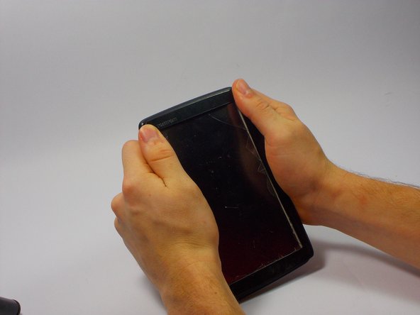

  4. TomTom VIA 1605TM Front Screen Replacement: crwdns2935265:04crwdnd2935265:01crwdnd2935265:03crwdne2935265:0 TomTom VIA 1605TM Front Screen Replacement: crwdns2935265:04crwdnd2935265:02crwdnd2935265:03crwdne2935265:0 TomTom VIA 1605TM Front Screen Replacement: crwdns2935265:04crwdnd2935265:03crwdnd2935265:03crwdne2935265:0
    • Place the new front panel (with new screen) on to the back panel. Press firmly along the edges to attach.
    • Only do this step of placing the front panel on if you are completed. If there are still components needed replacing postpone this step until the end.
To reassemble your device, follow these instructions in reverse order. Now you're done and your device is ready to use!
