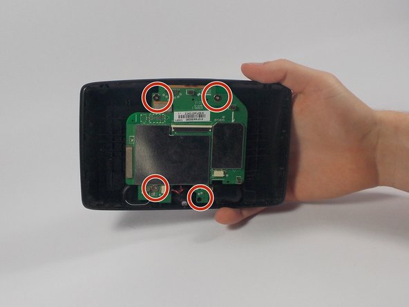

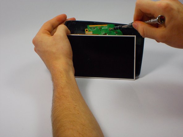

      • Keep the TOMTOM oriented so the curve is on the bottom. Locate the four 1mm Philips #J1 head screws attached to the motherboard.
      • Unscrew each of these in a counter clockwise direction.
      • When reassembling screw back in a clockwise direction.
      • The second picture is to represent where the four screws are located. The LCD screen does not disconnect from the motherboard until the next step

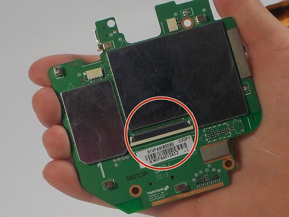

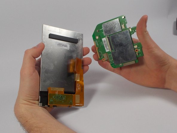

      • Remove the Blue Ribbon Cable by pushing each side of the plastic holder with the nylon spudger.
      • This will remove the LCD screen from the motherboard.

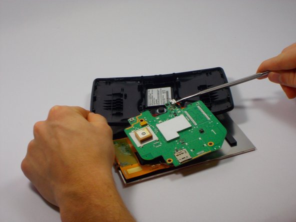

      • Unplug the wire connecting to the battery by pinching the sides connected to the front screen.
      • Pull back away (in the opposite direction) from the connector.
      • Lift the circuit board to reveal the battery beneath.
      • When reassembling push back into connector. Do not need to pinch anything. The "click" sound insures solid connection.

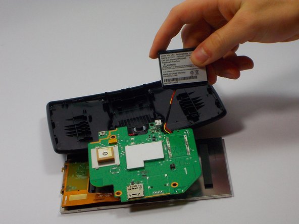

    4. TomTom VIA 1605TM Battery Replacement: crwdns2935265:08crwdnd2935265:01crwdnd2935265:02crwdne2935265:0 TomTom VIA 1605TM Battery Replacement: crwdns2935265:08crwdnd2935265:02crwdnd2935265:02crwdne2935265:0
      • Carefully pry loose using the plastic opening tool and remove the original battery.
      • Place the new battery where the old battery was located.
