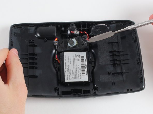

  6. TomTom VIA 1530 TM Speaker Replacement, Speaker: crwdns2935265:06crwdnd2935265:01crwdnd2935265:02crwdne2935265:0 TomTom VIA 1530 TM Speaker Replacement, Speaker: crwdns2935265:06crwdnd2935265:02crwdnd2935265:02crwdne2935265:0
    • Use the pointed edge of the spudger to pop the speaker out of its compartment.
    • The dense foam part is the speaker, not the immovable plastic.
    • It is more difficult to remove using the plastic opening tool, but it can still be done.
