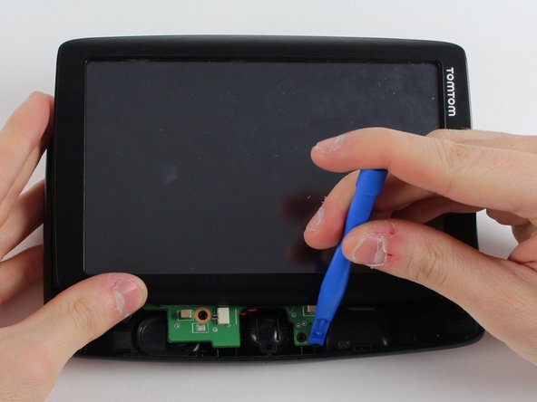

    • Flip the device over so that the screen is facing up.
    • Wedge the plastic opening tool between the top and bottom of the device's frame, gently sliding it around the outside edge.
    • It may be easier to start at one of the corners.
    • The gold ribbon cable connecting the screen to the motherboard is fragile and tears easily.
    • This specific device's ribbon cable is torn.

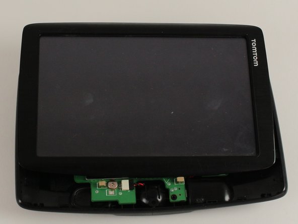

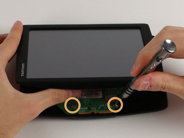

    • Carefully slide the screen forward, revealing the lower portion of the motherboard.
    • Remove the 3.6mm screw using the JIS #00 Screwdriver.
    • Rotate the device 180 degrees, carefully slide back the screen, and remove the remaining two screws.

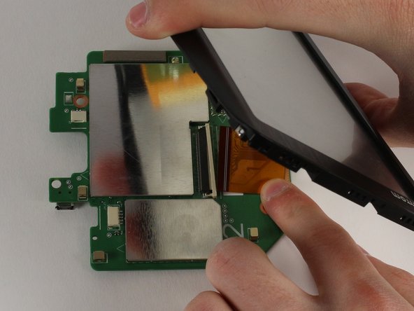

    • Disconnect the battery and speaker cables.
    • Unlatch the motherboard from the case.

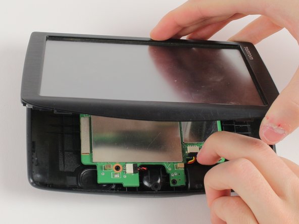

  6. TomTom VIA 1530 TM Screen Replacement, Motherboard: crwdns2935265:06crwdnd2935265:01crwdnd2935265:02crwdne2935265:0 TomTom VIA 1530 TM Screen Replacement, Motherboard: crwdns2935265:06crwdnd2935265:02crwdnd2935265:02crwdne2935265:0

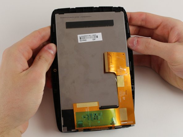

    • Wedge a spudger between the white plastic latch and the black connection port, disconnecting the gold ribbon cable.
    • Slide the gold ribbon cable out of the port.

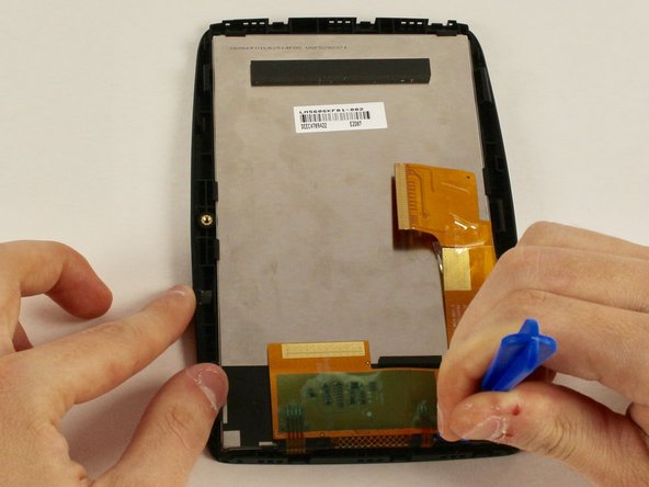

  7. TomTom VIA 1530 TM Screen Replacement, Screen: crwdns2935265:07crwdnd2935265:01crwdnd2935265:03crwdne2935265:0 TomTom VIA 1530 TM Screen Replacement, Screen: crwdns2935265:07crwdnd2935265:02crwdnd2935265:03crwdne2935265:0 TomTom VIA 1530 TM Screen Replacement, Screen: crwdns2935265:07crwdnd2935265:03crwdnd2935265:03crwdne2935265:0
    • Use a plastic opening tool to unlatch the screen from its case.
    • We recommend starting on the side with the gold ribbon cable as the latches are more tricky.
    • Unlatch the screen corner by corner instead of an entire side at one time.
    • The tearing sound is the adhesive holding the screen to the case. It will re-stick when you put the screen together.
